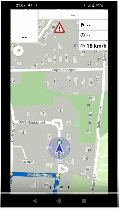

To your video: Why you don’t give a link to the route (short link or URL)?

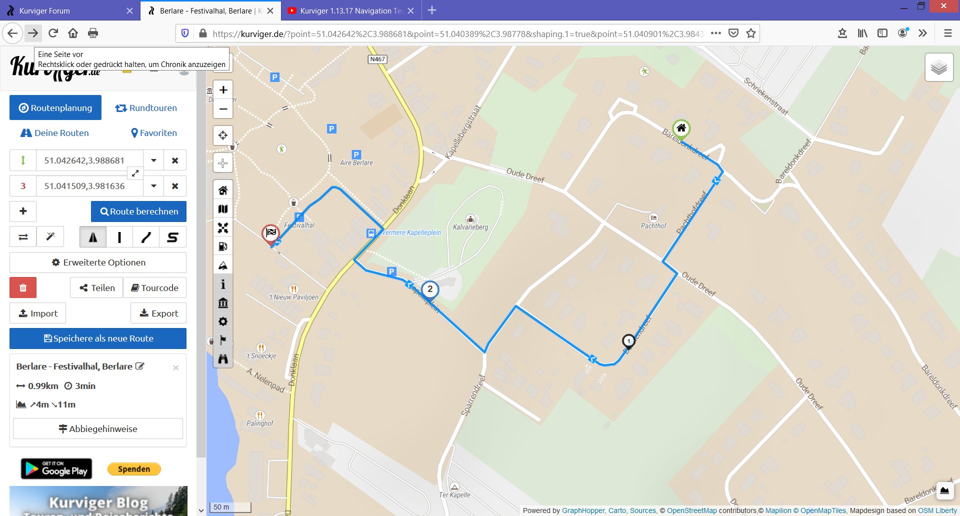

Spending a lot of time I reproduced your example.

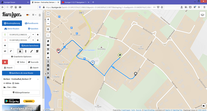

The initial route seems to be https://kurv.gr/Lcdy4.
Without the shaping point in the Dennendreef it is https://kurv.gr/LbfAG.

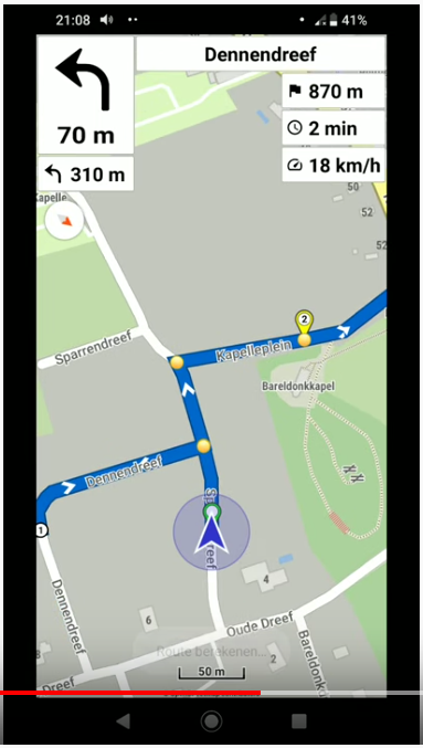

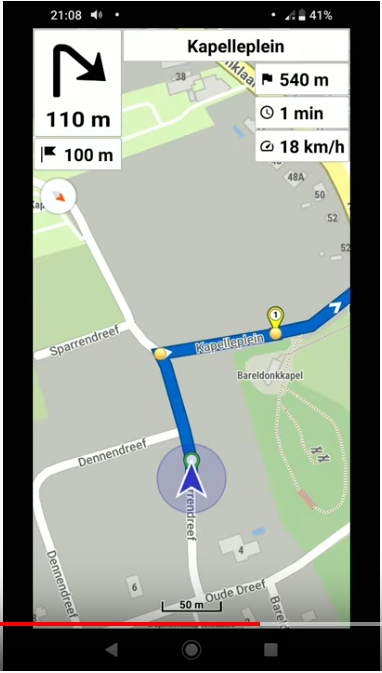

In your video you leave the initial route (in Bareldonkdreev you go straight on instead of turn left). Then rerouting is done:
Rerouting is done that you can drive forward, You don’t have to make a U-turn.

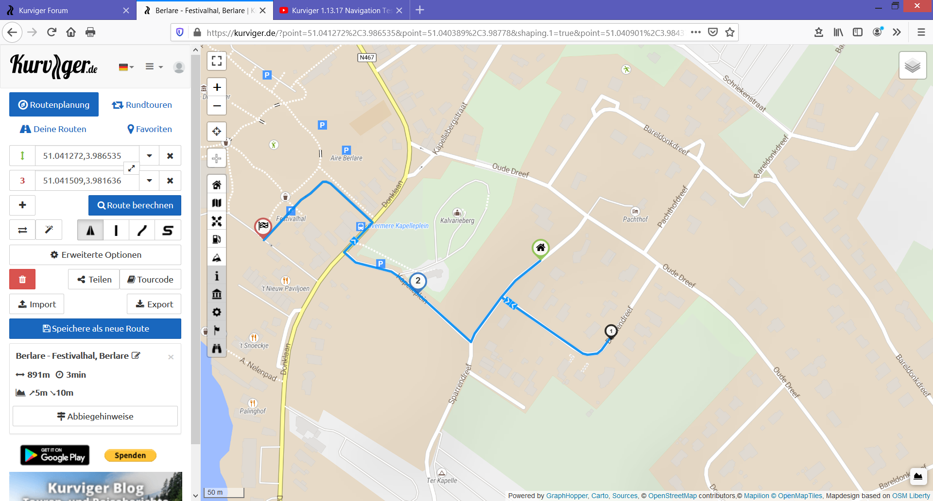

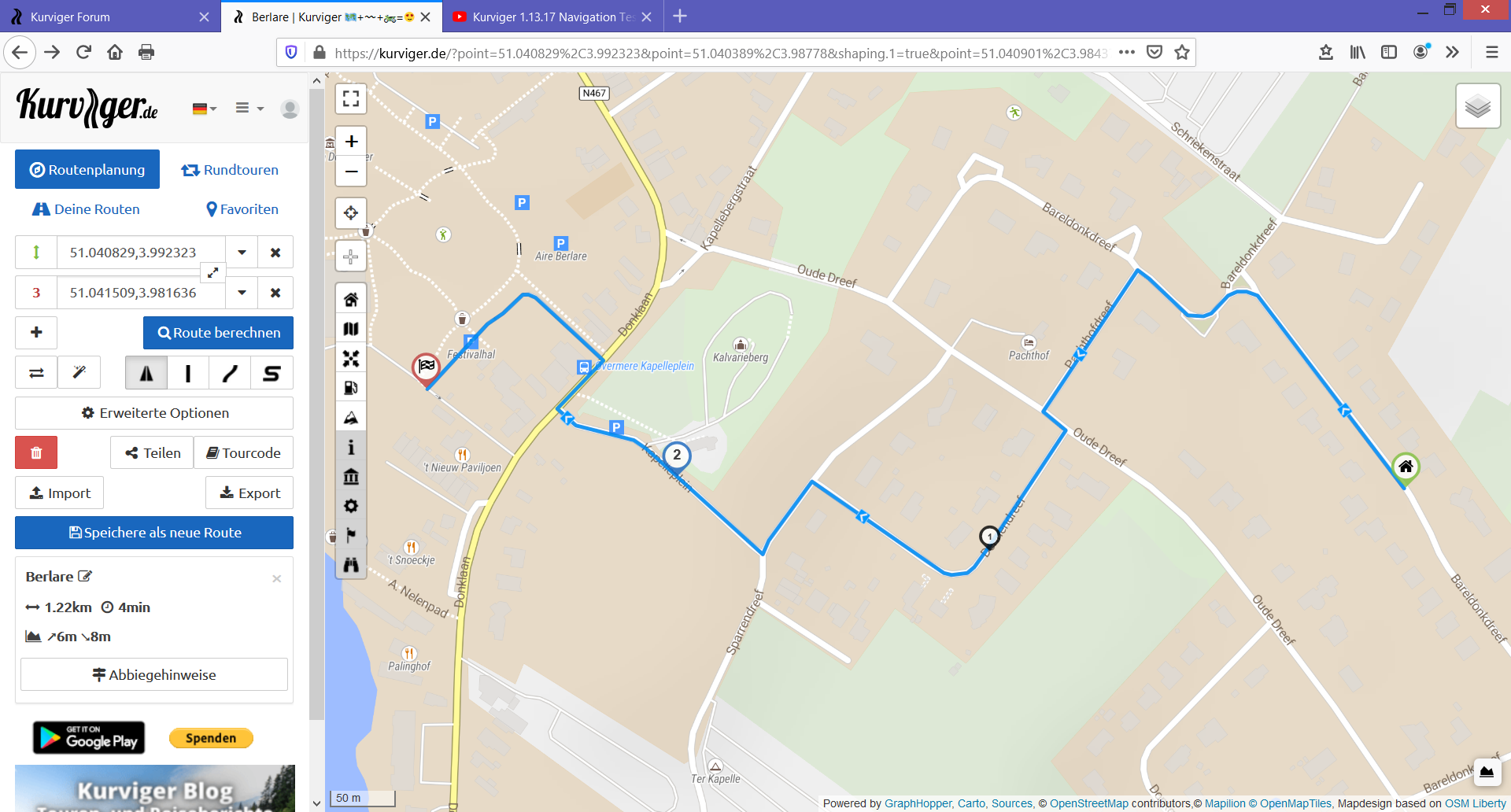

To rebuild the remaining route i had to move the position behind the curve seeing in the picture above. The route is https://kurv.gr/Ebkbp.

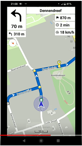

When taking the position of the rerouting the route would be
Here a U-turn would be necessary! But the Kurviger method of rerouting let you drive without U-turn! Well done, Kurviger! That we have a rerouting as done, avoyding A U-turn!

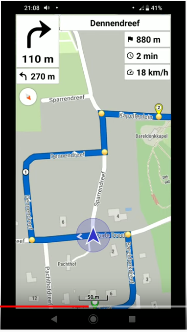

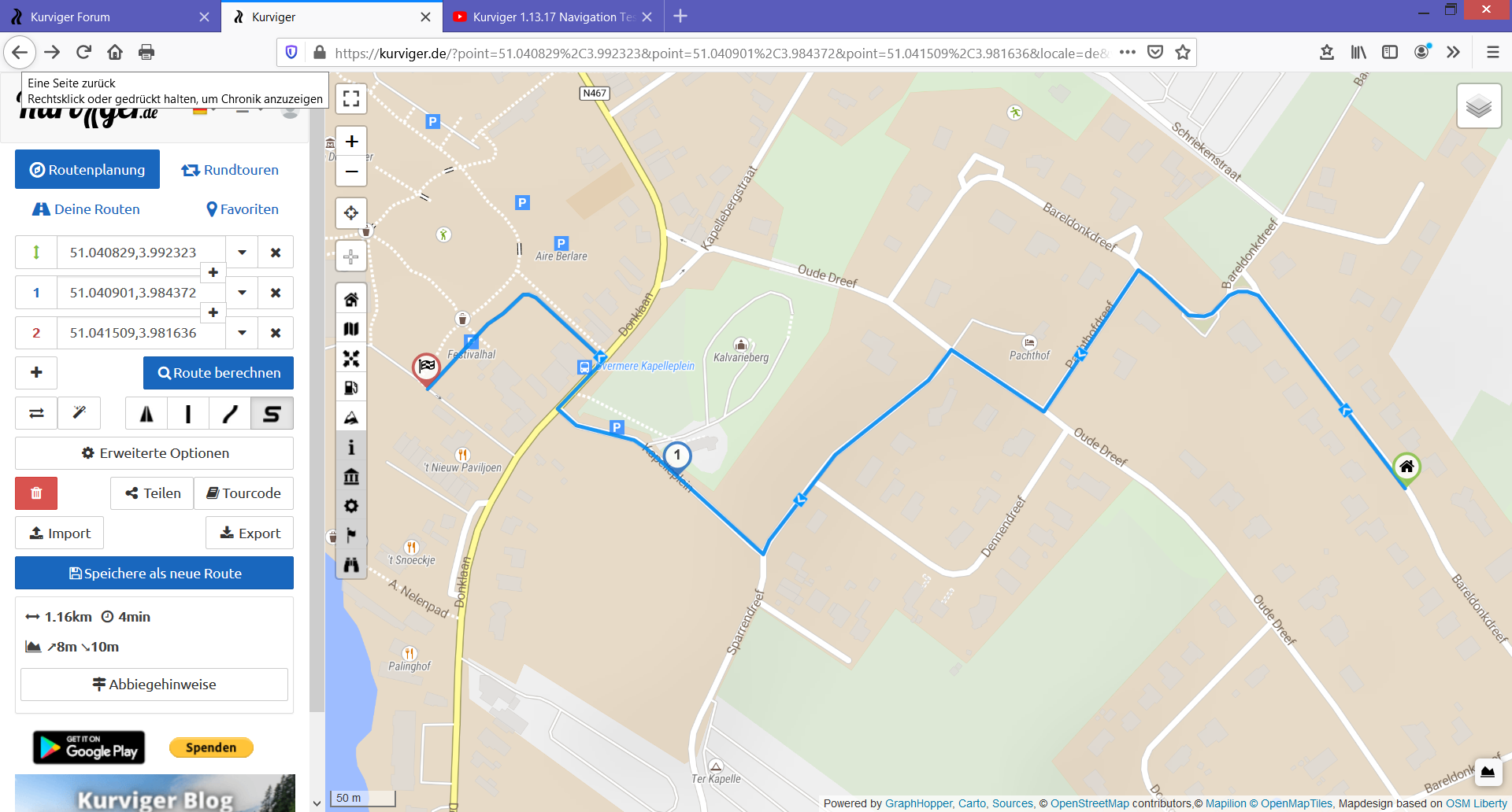

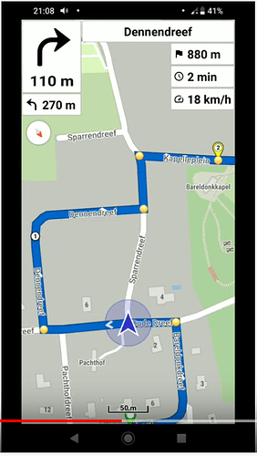

You leave the route of the rerouting at the Oude Dreev. Instead of going straigt on you turn right in the Sparrendreev. Rerouting is done.
The route is https://kurv.gr/6gDRv.
As we can see, the shaping point is not ignored!
And this is what I like at the current Kurviger Method! When I don’t want to pass a certain road segment (represented by a shaping point in this segement) then I don’t need setting a shaping point there! And when setting a shaping point then it should not be ignored by Kurviger. This currently is solved excelent in Kurviger in the flexible and strict mode at rerouting!

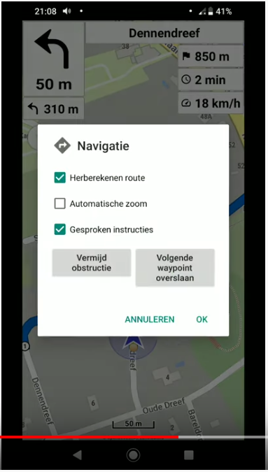

In this case the solution in Kurviger is to skip the next waypoint. It seems that you used this action.
