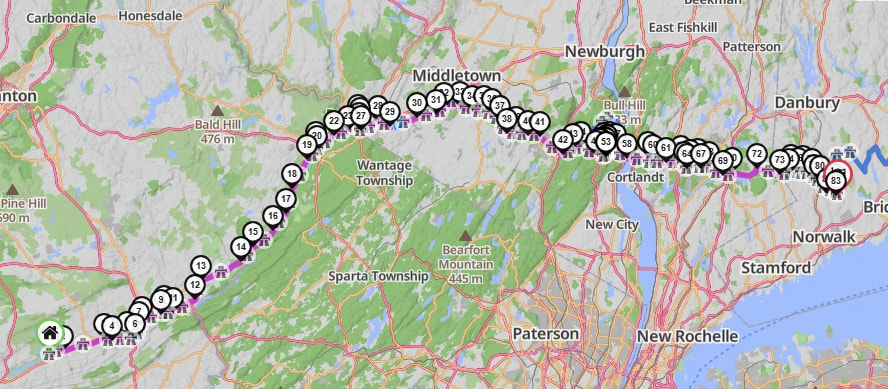

Hi, I planned a trip that had 12 waypoints in it, used navigation while riding, finished the trip and saved the trip.. When I look up the trip now it has 83 added waypoints that were not in the original route.. What did I do wrong? Thanks, Joe
Hi @TurboJoe,
I think you did not load your planned route but your ride recording as a route. When you do the latter, Kurviger tries to “translate” your “track” into a route again, thereby adding waypoints.
Depending on what your goal is, you could load your ride recording as a map overlay. You can also load the original route if you saved it in the cloud.
You can also do both at the same time and adjust your originally planned route to match the recorded ride.
What is your goal? :slight_smile:
