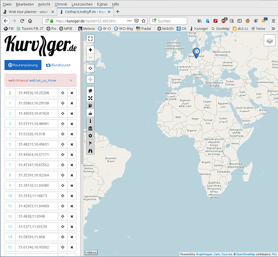

Hi Petra, can you show us a Screenshot from when that happens please? I’d like to see what your url, your waypoints and the error message looks like

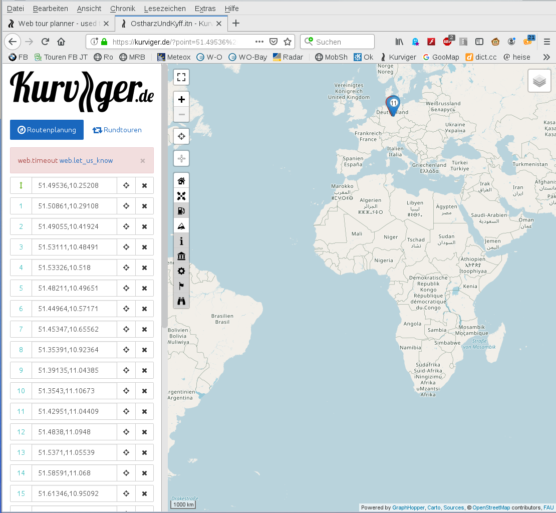

Sure: Here comes the screen after trying to import a tour consisting of about 21 points.

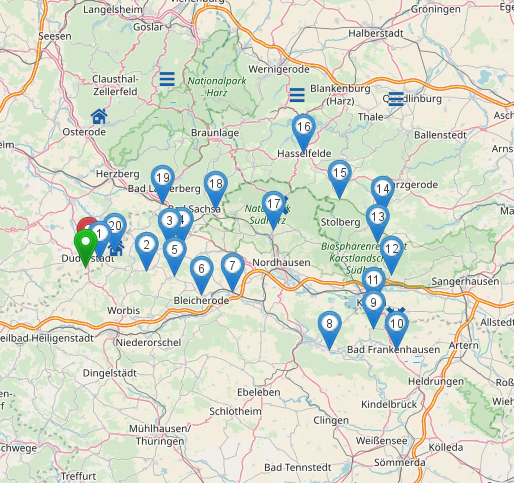

Normally I find the loaded tour centered and magnified to fit into the browser window, with the course of the tour shown as line.
If I center and magnify the obviously loaded route points the absence of the route course is obvious:
Trying to rebuild the tour by choosing another routing option (extra curvy instead of curvy, e.g.) reproduces the same error message as shown in my last post. And, of course no routing course.
Hmm, very interesting, that does indeed look like some kind of broken API request to Kurviger, almost like your connection allows traffic to Kurviger itself but not to some scripts or backend resources it needs… :thinking:

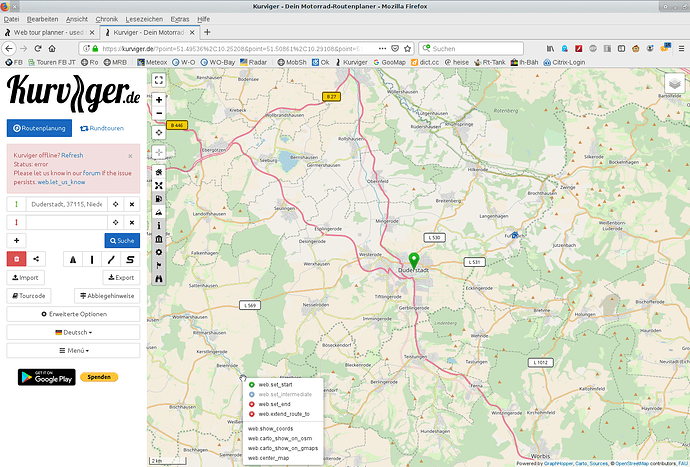

Another interesting detail, as I just tried to define a new, super-simple route into the present vicinity: A right-click into the map, to define an end point of the two-point tour, showed a very unexpected design of the appearing box, as shown in the following browser screenshot. Perhaps this gives you some idea:
Wow yeah ok there is most definitely some css or some other resources not loading. I’m out of my depth here (I’m not a developer for kurviger) and we’ll have to wait and see if @boldtrn finds some time to check this out.
