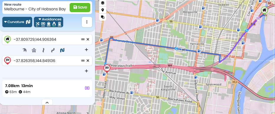

There’s a new tunnel in Melbourne Australia called the Westgate Tunnel. When planning a route Kurviger seemed to think I could exit the tunnel where I couldn’t. The route had setting for avoid tolls so this may be why it tired to avoid it but I’d have thought it would respect what you can and can’t do. I reduced the route to start at a valid entry and a valid exit and it still tried to exit.
That right turn it says to do (Hughes Street) is when you are still in the tunnel.

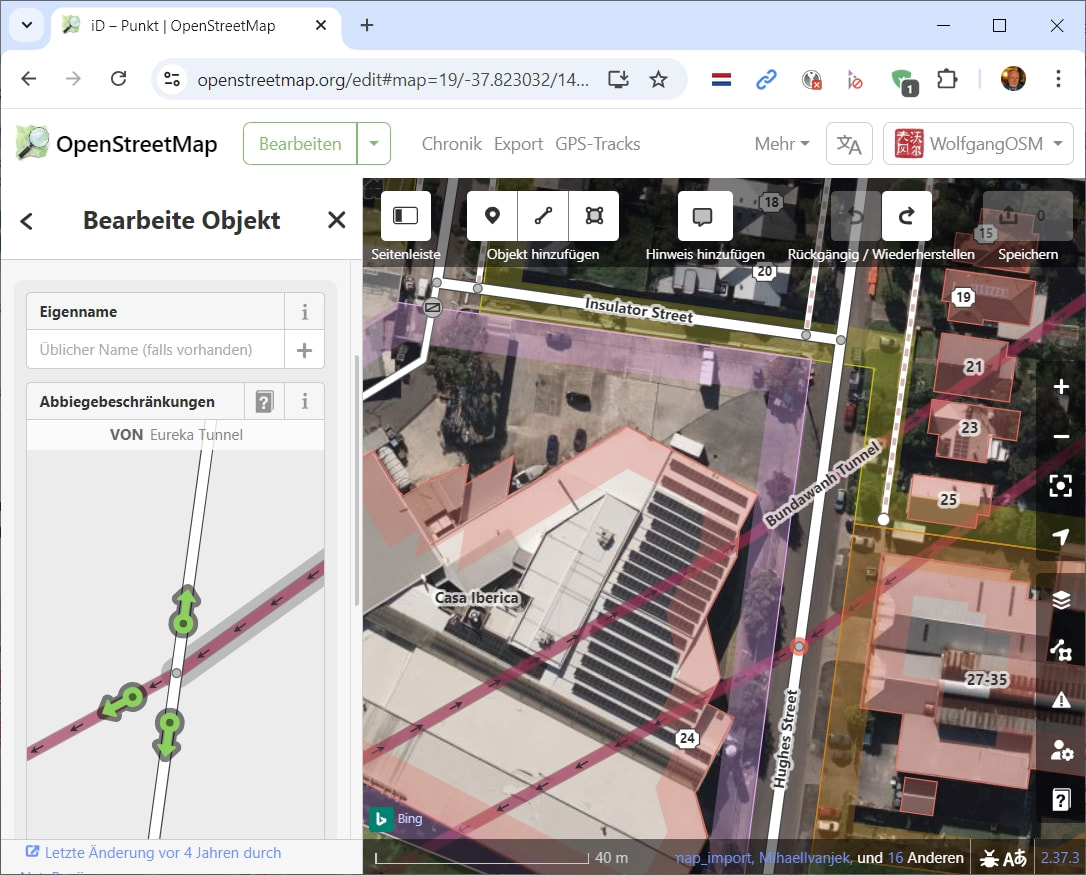

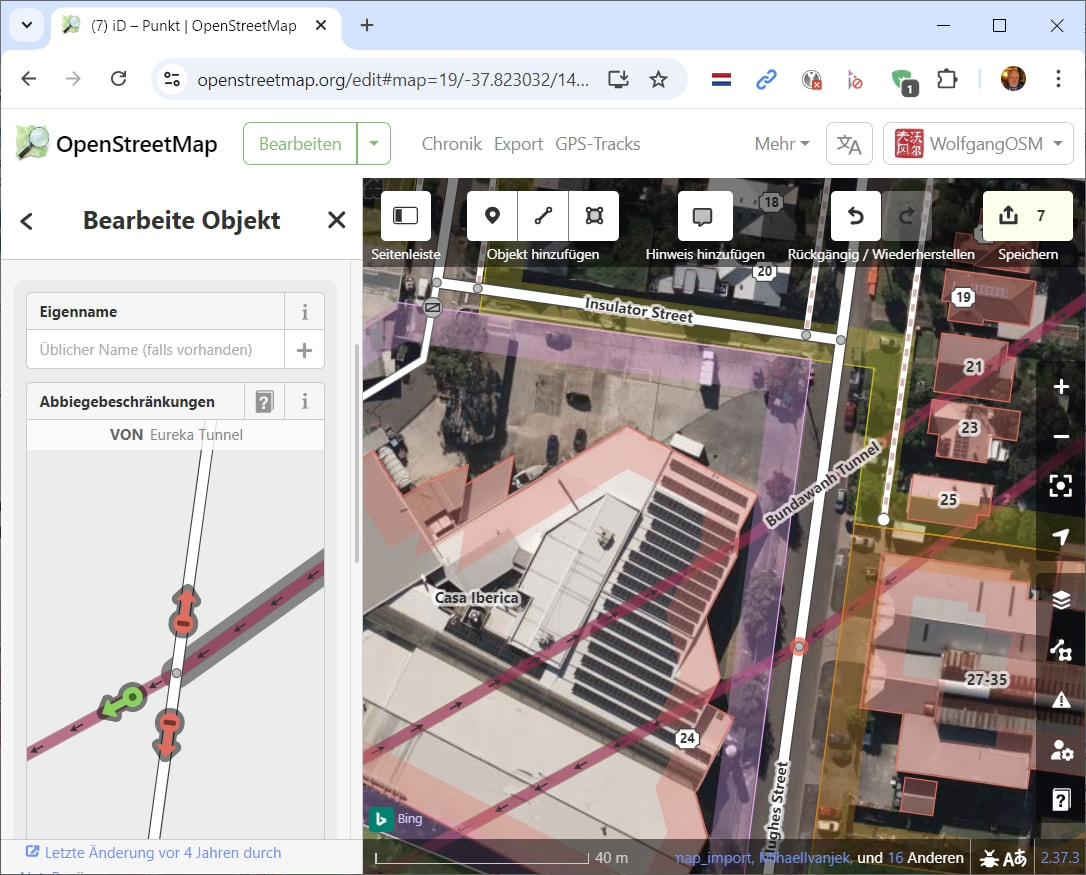

A defined turnpoint ingnores the difference in height between the tunnel and the surface. I’ve corrected it:
Before
After
In few days it should be imported in Kurviger as well.

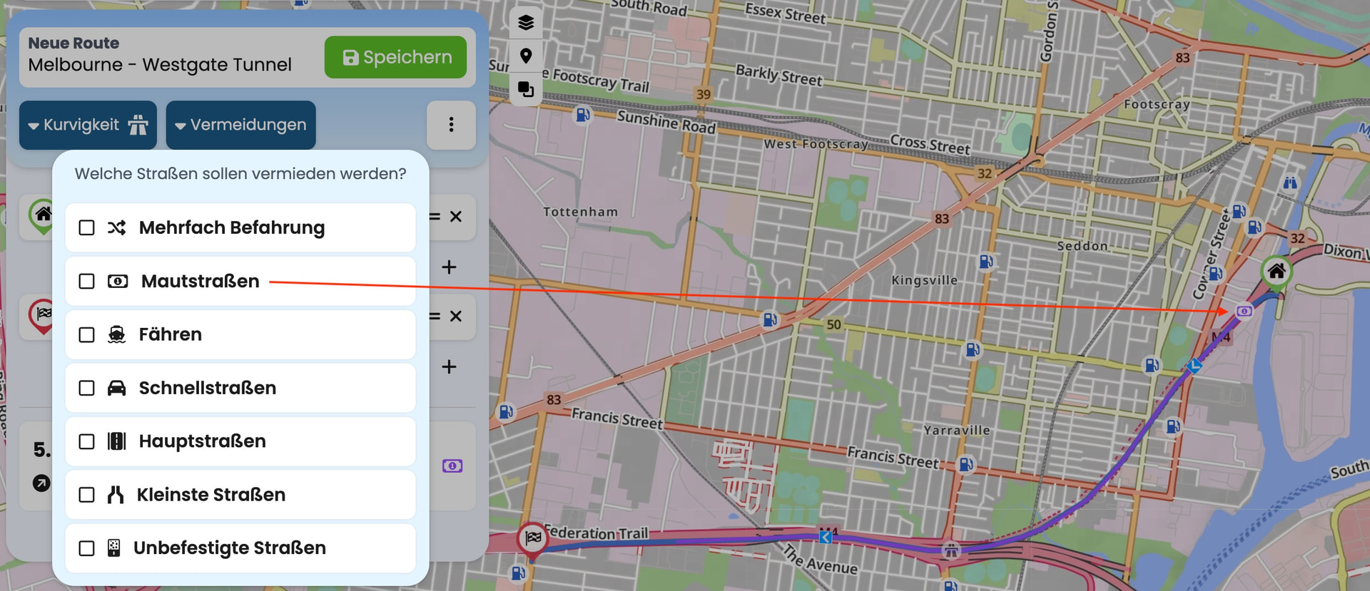

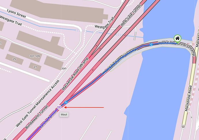

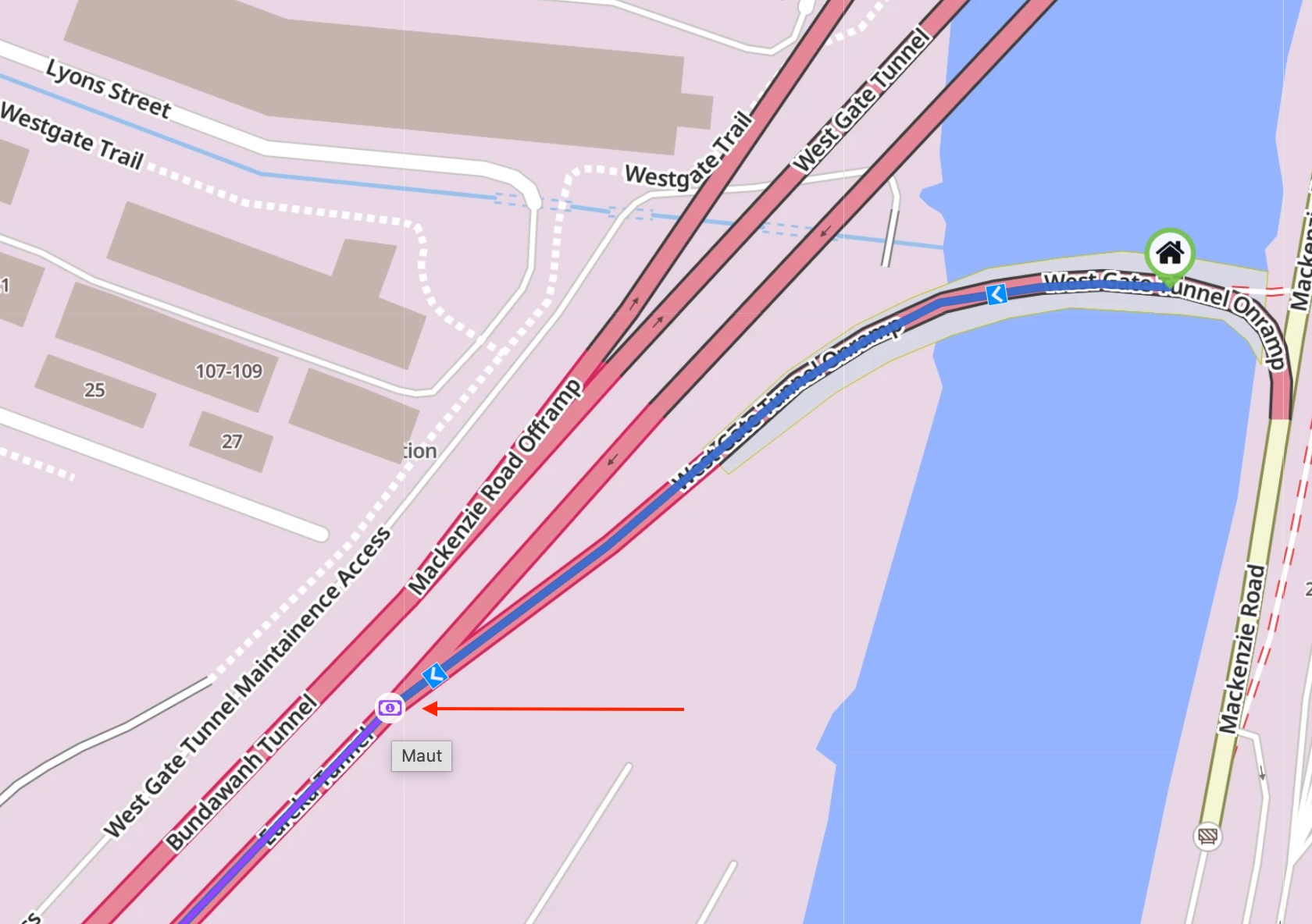

Nevertheless Kurviger will leave the toll-route as soon as possible if you specify “avoid toll” (your startpoint is already on the toll-route).
Is this point required or should it better be deleted, and the tunnel connected and not splitted at this point?
The Westgate Tunnel is marked as tolled,
so the tunnel is exited.

Maybe that’s right - feel free to do it.
You are right: 2 ways without junction should not have a common node, because a node is interpreted as a junction.
Please see “Nodes on ways” in
If highways or railways cross at different heights without connecting they should not share a node
So I mapped your proposal in OSM.
