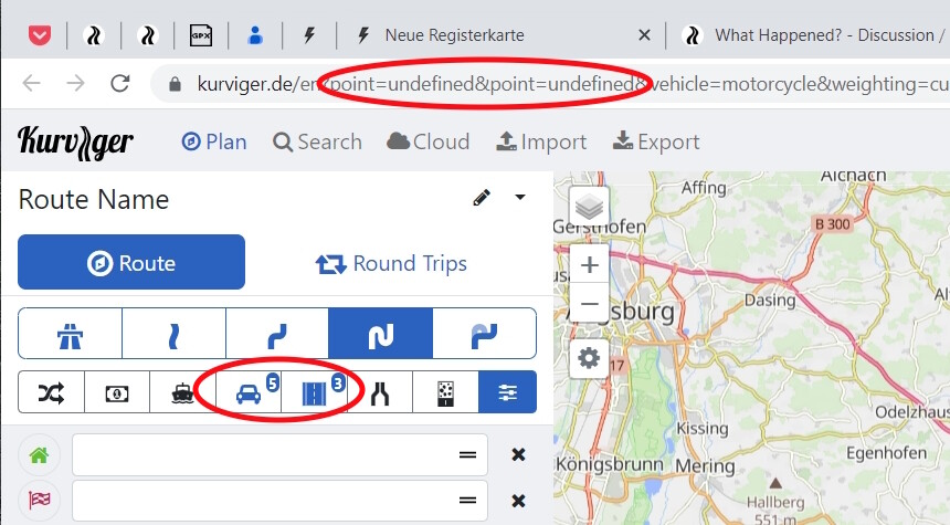

Hi Robert, your link does not work. I see an empty route. Your link starts with point=undefined&point=undefined. Please load your route to Kurviger then generate a new link.
No - your route is empty, as @Ben already said.
But: your avoidance options restrict kurviger to just small roads, may be that’s the problem. “Avoiding avoidances” is the better way - give it a try …
O.K., that fixed the problem, THANK YOU very much. I must have touched something or hit a wrong button, either way all is well. I’m still getting used to your very fine app but am enjoying it very much. Have a great week…
