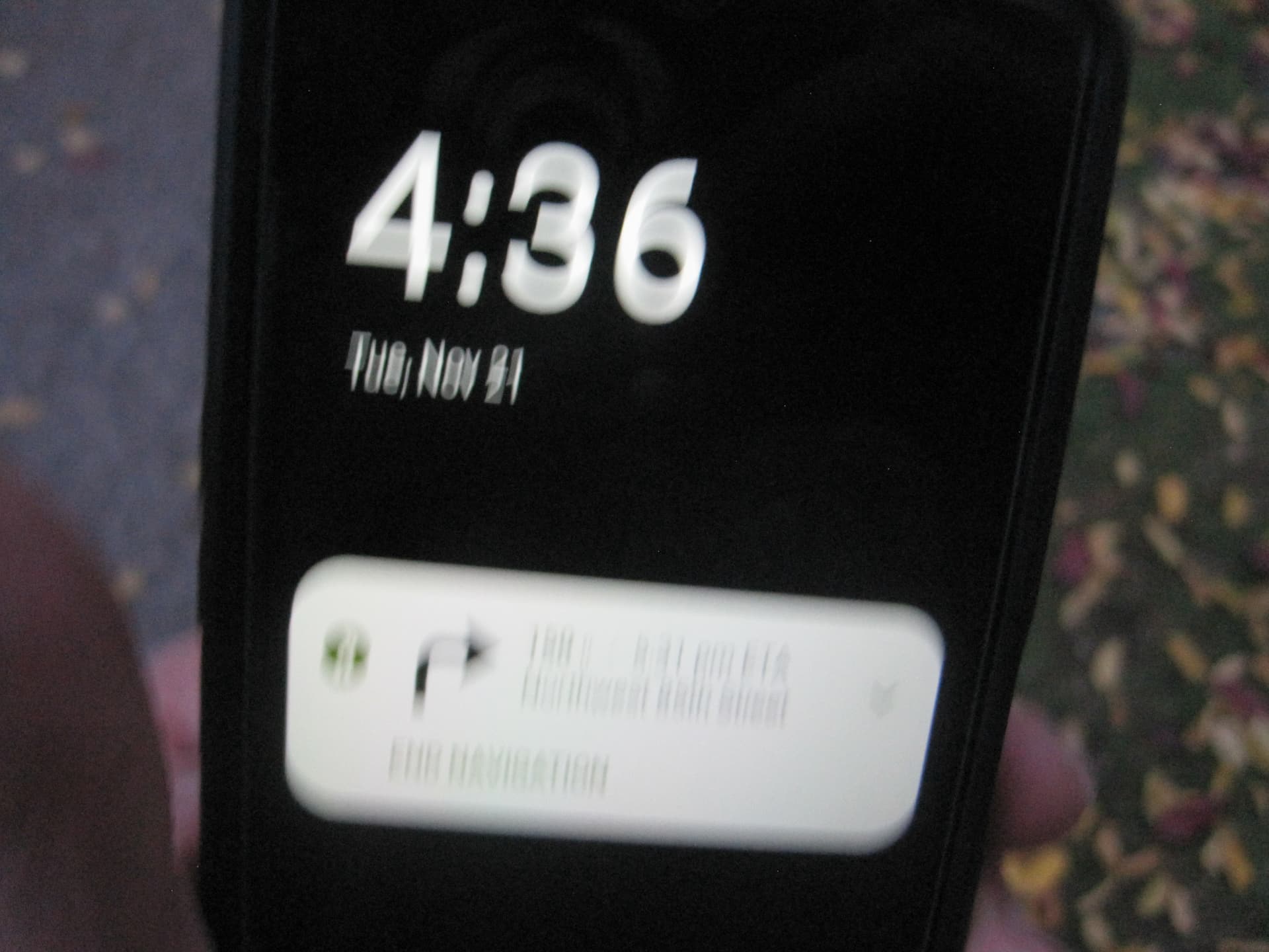

Thanks for the explanation. Do you have any idea why the arrow with the turn instructions and the clock are showing up on an otherwise blank screen?

It would be difficult to capture. It only starts happening sometime after I begin navigating and turns on and off seemingly at random. Picture the “next turn” arrow that Kurviger displays during navigation appearing on a blank screen along with the clock display for 30 seconds and then disappearing again. It makes no difference how far I am from the next turn. If I stopped and tried to do a screen capture, the display would naturally change before I could capture it. It may, of course, be related to my phone, a REVVL V+ 5G.

I tried to do this while riding but any time it popped up and I pulled over it went away. So I got off and started walking with the camera in one hand and the phone in the other. With all the glare and reflections you can’t see the clock at the top of the phone but you can see the turn instruction. These would stay on the screen about 10 or 20 seconds. When it goes off, if I’m no longer moving it stays off. Clearly not a studio quality photo, sorry.
An equally bad photo with different lighting showing the clock as well as the arrow. It seems to want to tell me there is a turn up ahead but the message and clock are illuminated only briefly.
Thanks for the pictures and now it’s clear.
This is the Android notification. When the navigation is running and you move Kurviger to the background, the navigation continues and you hear the voice prompts. In addition, a rudimentary display is shown in the start/lock screen above the notification field.
