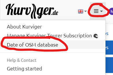

It should work in a few days, when the kurviger OSM database has been updated. You can see the date of the database on kurviger website:
