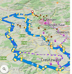

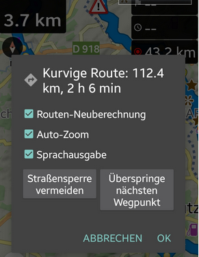

I have settings → navigation → rerouting mode set to “next unvisited waypoint”. My action cam was connected to WIFI direct in order to access it with the Cam App. Internet connection was working. I have passed already 2 of my waypoints, but couldn’t drive to the 3rd
So I used the menu “skip next waypoint”
In my expectation the kurviger app would know that I have already passed wp1 and wp2 and this should skip the wp3 and route me to the wp4. But this doesn’t work at all. It deletes the wp1, 2 and 3 and starts calculation, but then suddently the wp3 is back as new wp1, get’s NOT deleted and kurviger calculates to whatever and whereever, but not the wp4. I have pressed the “skip next waypoint” button a dozen times and more, but it also happens that all my waypoints are back and the calculation is to “I don’t know which waypoint”, but not the one that I want, wp4.
Even when I am almost back at my starting position, all the waypoints are still there.
The button “skip next waypoint” doesn’t skip or delte any wp.

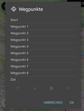

I have even stopped and manually deleted all wp’s in this menu
But the route is still there and the calculation is NOT to my destination (last wp = goal)
Also using this
grafik
for recalculation doesn#t work
Even all the wp’s come back… it is an absolute desaster… I really fear the I have to drive all my routes 2020 with another navigation app. I wanted to use Kurviger, but with this result I can’t. This is a pity.

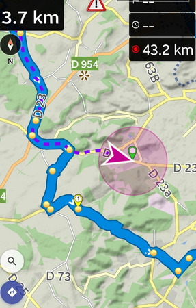

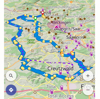

This image looks a bit weird, the net waypoint is correctly set to WP 1, but the route is not recalculated. Then in this image:
It looks completely different again.
To me this really sounds like you hadn’t had internet access. If no recalculation worked, even after manually deleting the waypoints, then most probably that’s what happened.

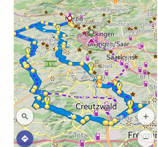

I thought about this case a bit more and I really think that there was an issue with the internet connection. If I delete a waypoint in the waypoint list without internet connection, the waypoint is removed from the map, but the route stays the same. Like in the screenshot above.

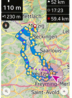

I also did this 5 km before my final destination, but still off the planned route since I took a different way as planned. NO recalculation was made, skipping waypoints didn’t work.
Ok it works then, but this helps me less, when it is not working on the road.
And again: when I try this at home with manually disconnected internet, I get the message “no internet connection”. But I didn’t have this message yesterday on the road.
