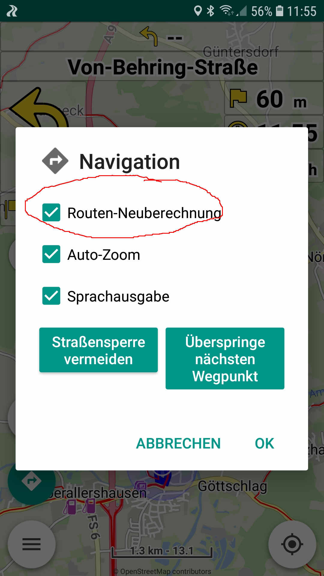

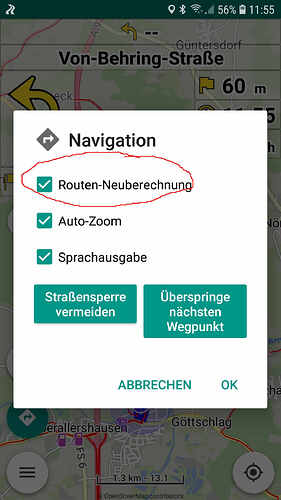

Why not simply deactivate automatic recalculation during that detour?
Can be done in 3 clicks.
Click navigaton panel → uncheck “recalculate route” → click OK
It will be available in the next app update.
