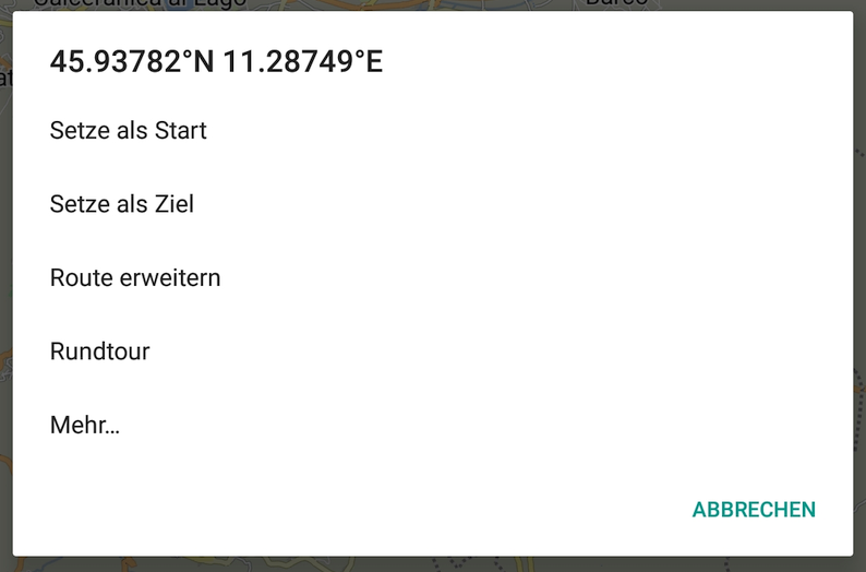

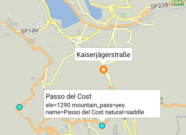

After importing GPX with waypoints (XML tag <wpt>) as overlay they are shown on map and can be also tapped to show information (same way as bookmarks):

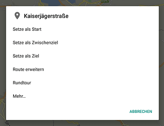

Bookmarks can be added to route as waypoint via long tap on it (context menu), the name of the bookmark is copied to waypoint name automatically:

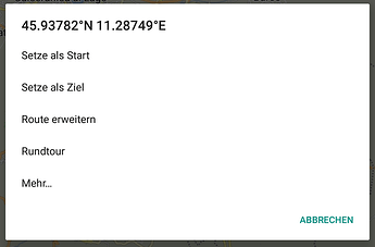

But overlay waypoints can not be added so easy - trying a long tap on them seems just to hit the coordinates:
My suggestion: Add the same context menu (long tap on them) to overlay waypoints as to bookmarks.

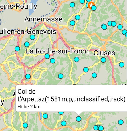

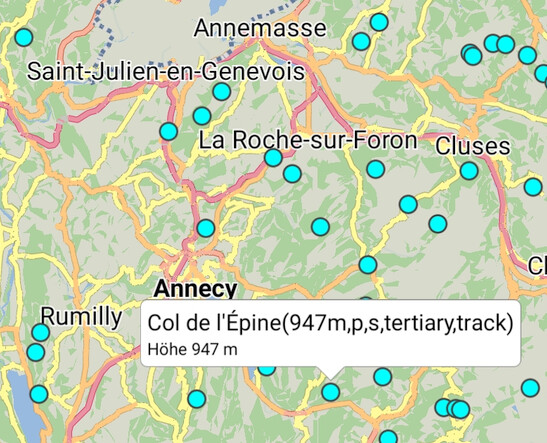

The <ele> tag is also used by the Kurviger app when importing GPX as overlay :+1:, but for passes with an elevation >= 1000m the elevation is shown with unit ‘km’ without any decimals. Passes with lower elevation are shown in m (german screenshots: “Höhe” = Height / Elevation):
I think it would be useful to show the elevation always in m.
