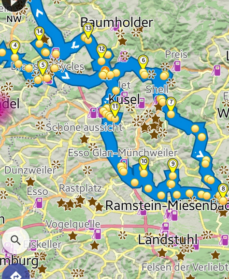

New Version is not yet available, but I’ve played around with flightmode and online mode, because of the question what is calculated new in the fallback mode, the complete route or only the route from the actual position to the next unvisited waypoint (depending of this setting). It would be good if only the route to the next waypoint would be recalculated and not the complete route, because this changes a lot. The fallback scenario should be in my point of view just a way to get a drivable route to the next wp, but actually the complete route is recalculated and this makes the planned curvy road looking a bit weird, also with the effect of turning instructions.
example: this was calculated in flight mode
you see that for example in wp14 it drives back and takes the freeway and in point 9 it takes the way back
in online mode it looks like this
When I just switch between flight and online mode, the route isn’t changed. This means in order to get a new calculation I have to skip a waypoint, then I have again the curvy road.
Did I explain it well? What I want to say is, in case someone really wants to have the complete route recalculated, there should be another option for this
o complete route
o waypoint only
What is your opinion? In any case I would prefert option 2 as default.
Sorry, it’s difficult to understand the meaning and nearly impossible from images.
Rerouting follows the rerouting mode in settings - regardless internet availability.

And it was only a simulation in previous version, no reality. I will test the 1.12.1 in practice on the bike as soon as the weather conditions are allowing it. Already starting in rain is not fun. In any case having the option is a big benefit. ![]()
When you are testing offline routing, you must distinguish between the different situations.
In case of a rerouting while navigating I would expect a route change only up to the next WP; rest of the route should be unchanged.
If you change the route e.g. by inserting a new WP I would expect a complete new route.

All these already work, I copy here the relevant section from offline routing announcement:
(seen above and in Beta topic)
- Route planning: all routing calculations fallback to offline routing profile when there is no online connection.
- Navigation: offline partial rerouting is calculated from user’s location to the route (based on rerouting mode).
Offline reroute section joins the rest of the existing curvy route and navigation continues on the merged route.
Every other “rerouting” nav activity should work similarly offline, like avoid road block or skip next waypoint.
An offline routing guide for both GraphHopper + BRouter exists now in our Wiki documentation.
