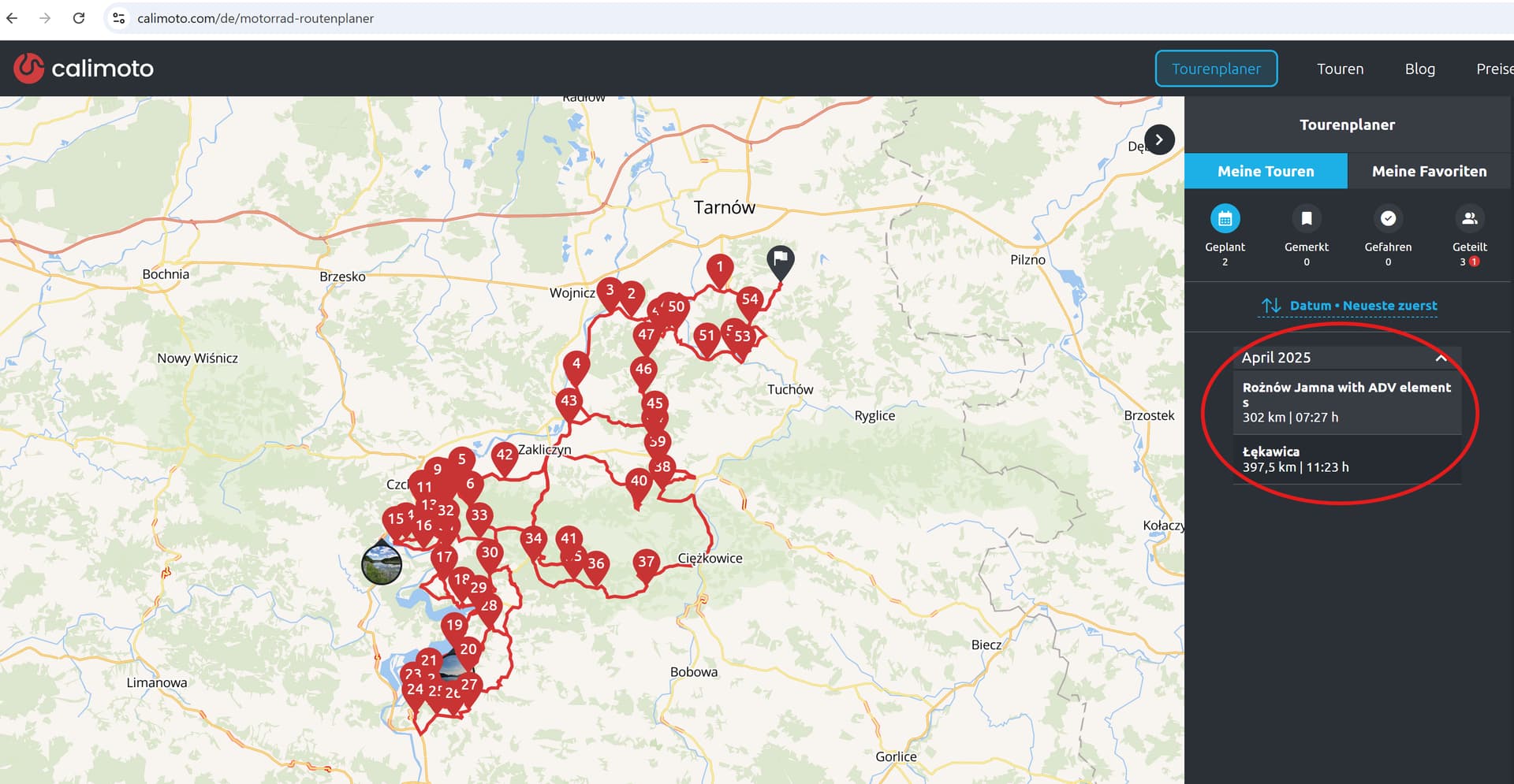

I just doublechecked your samples in the linked thread, both contain gravel roads, I guess this leads to the long ETA. However, when throwing them as gpx into Calimoto I receive this result (due to import deviation longer distances then in Kurviger, but even there no suiting ETA):
While downcalculating to the real distance of your samples with an average factor we have an ETA in Calimoto for the first route of 4:23 h and 6:20 h for the second one. This significantly deviates from your statement:
Would you mind to explain? Or did I make a mistake?

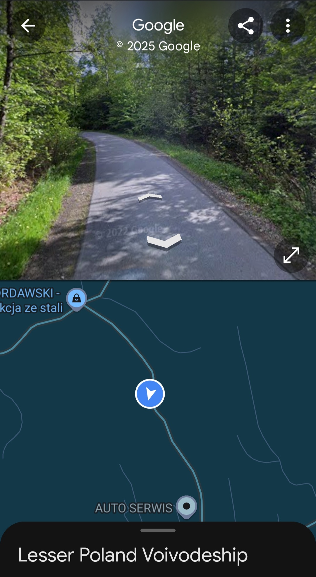

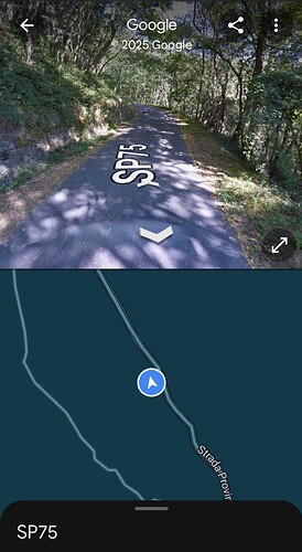

I am not sure if the elevation is accouned for in the algorithm, but it should be. If the route goes 1200m up and 900m down on a 17km section, the average speed will be lower then on the same distance where the the elevation changes 240m up and 380m down. Having had a look at google street view, the two roads do not appear to be that much different in terms of width and road surface, whatever the OSM tags may say:
Italy:
Poland:

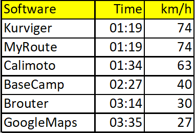

Good luck - then you may try to fix those bugs in their forums as well. MyRoute counts the same 1:19 for this segment, and Calimoto is slightly “better” with 1:34.
Here a comparison of some planning results:
BaseCamp and GoogleMaps I picked from this thread, the others are testet on the corresponding websites.
Because in the discussed route segment are only few cities to drive through (except San Remo) the time of 01:19 is challenging but achievable. An average speed of 40 or even lower is ridiculous.

An interesting idea. I gave it some thought and as a result I must disagree. I do not see how a change in elevation would consistently translate into a change in speed that could be reliably factored in ETA estimation. Most of the time, I think, there’s no influence, and when there is, it could go both ways (faster or slower).

Well, I would argue, that the higher the gradient is, the more hairpin curves you will have. The more hairpins - the more you brake and accelerate, reducing your overall average speed. But that is just an hypothesis, which can be verified by evaluating data.
