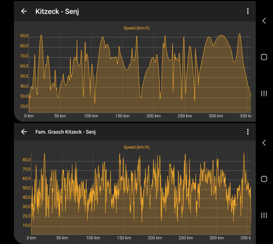

  1. Kurviger does not export timestamps very accurately, still I used them to compare Kurviger speed (above) with your actual speed over the distance. It appears that they roughly match, athough Kurviger appears to be much smoother. This is due to the fact that your GPX contains much more data points than Kurviger exported GPX. Kurviger appears to be slightly faster on average maybe some 10-15%

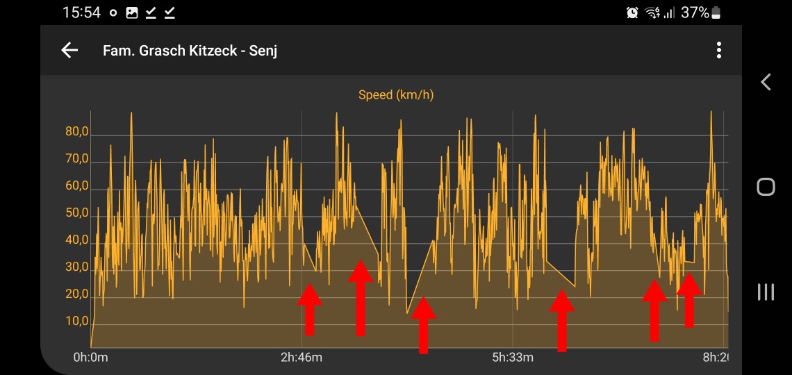

  2. If I look at your speed diagram over the ride duration, then it seems that you took roughly 6 short breaks which amount to maybe 1:15-1:30. If I deduct this from your overall time of about 8:20, I would probably get somewhere slightly below 7h of effective ride time. Kurviger does not account for your ride breaks. The difference between 6 and 7 hours is about 15%. Not perfect, but who is.
My conclusion - I could not detect a huge errors in the time calculation, but yes, Kurviger is somewhat optimistic in this case.

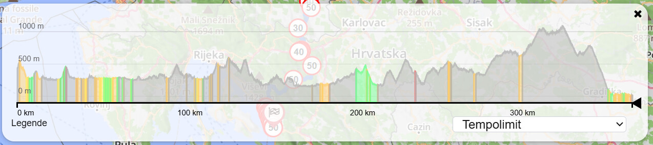

When you check the speed limits there are many grey areas = no speed limit maintained is OSM. Then the algorithm must assume.
I check a part and it was a “secondary” (no main road or fast road). This were 132km/2h = 66 km/h. To my experience Kurviger already calculates conservative around 15-20% less than allowed.
My tipp: Check the speed limits in the graphic for grey areas (then in the map in blue). If there are a lot, then double check with your experience e.g. 45-50 km/h.

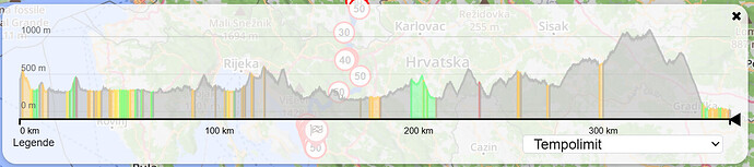

@RoboMobile this is what is meant with “grey areas” (literally gray on the picture):
On roughly 80% of your route there is no speed limit data in OSM. I have sample-checked from other sources - some grey sections are actually limited to 50km/h. If there is no data Kurviger would probably assume default speed limit in non-urban area (probably 80km/h in Croatia). This would then cause the difference in estimated and real times.

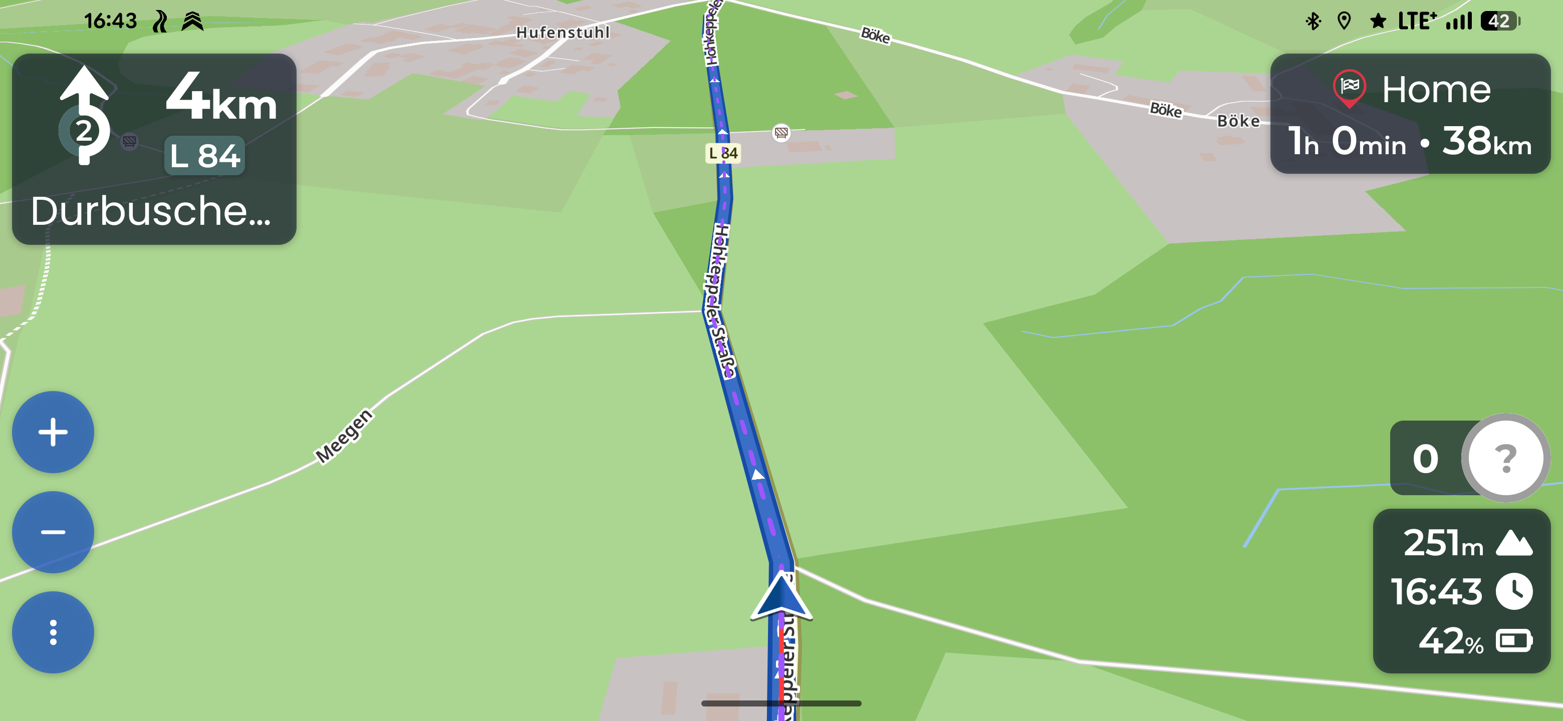

Hier ist ein Screenshot von meiner heutigen Fahrt
Durchschniitsgeschwindigkeit zu diesem Moment war um 50kmh.
Die restlichen 38Km waren hauptsächlich Landstrasse und etwas Stadt mit 50 und 2 mal 30kmh Strassen.
Sieht man auch im Streckenprofil.
Wie kommt Kurviger auf die 38kmh Vorhersage?
Hier ist die Route. Screenshot wurde am WP2 gemacht
Wielange hast du reell für die 38 km und für die Gesamtstrecke gebraucht?
40 Minuten und es wären noch weniger, wenn nicht ne Stau auf der Autobahnbrücke, wovon Kurviger auch nicht wissen könnte. Also 38kmh ist waaaay off!
