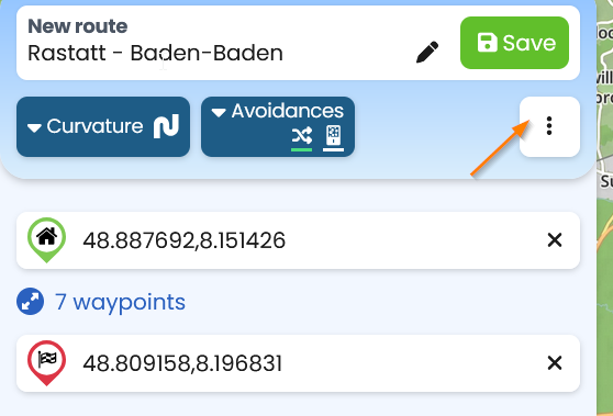

  1. Better overview of stops
The route panel on the left still shows all the shaping points, so the listing becomes very large. I would really like to see an overview of my stops instead. I know that there is a “Collapse waypoint list”, but I miss a “Viapoints only” view.

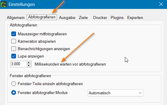

My proposal is to install (for example) free software Greenshot (Link). In the settings you can configure a delay from activation to screenshot. I have configured for me 3 seconds - enough time also to open menüs and submenus.

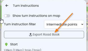

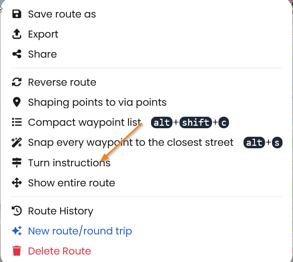

Hi Thorsten
Thank you very much for your answers. I did not know about the Turn Instructions, this is what I was looking for. Thank you.

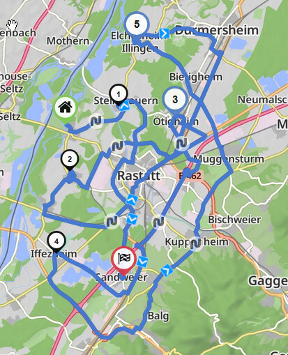

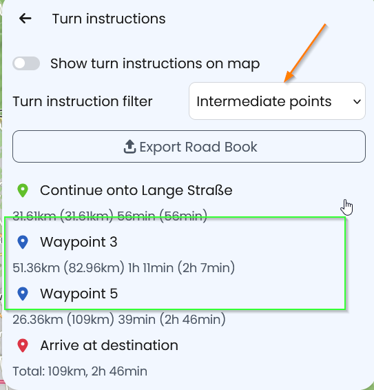

About the stops. Here is a route I am planning to suggest to the group I ride with. I managed to make a screenshot without the shaping points, so I am left with the 8 stops. But on the screenshot I sent to my group, the “stops” are now counting strangely, and it is difficult to relate each stop in the turn instructions list, with the location on the map.
Interesting. You want to simplify the information for your group. In case the the via-points are named (as you did) the number is not visible anymore.

Adding the waypoint-numbers to the list of turning instructions would also help.
