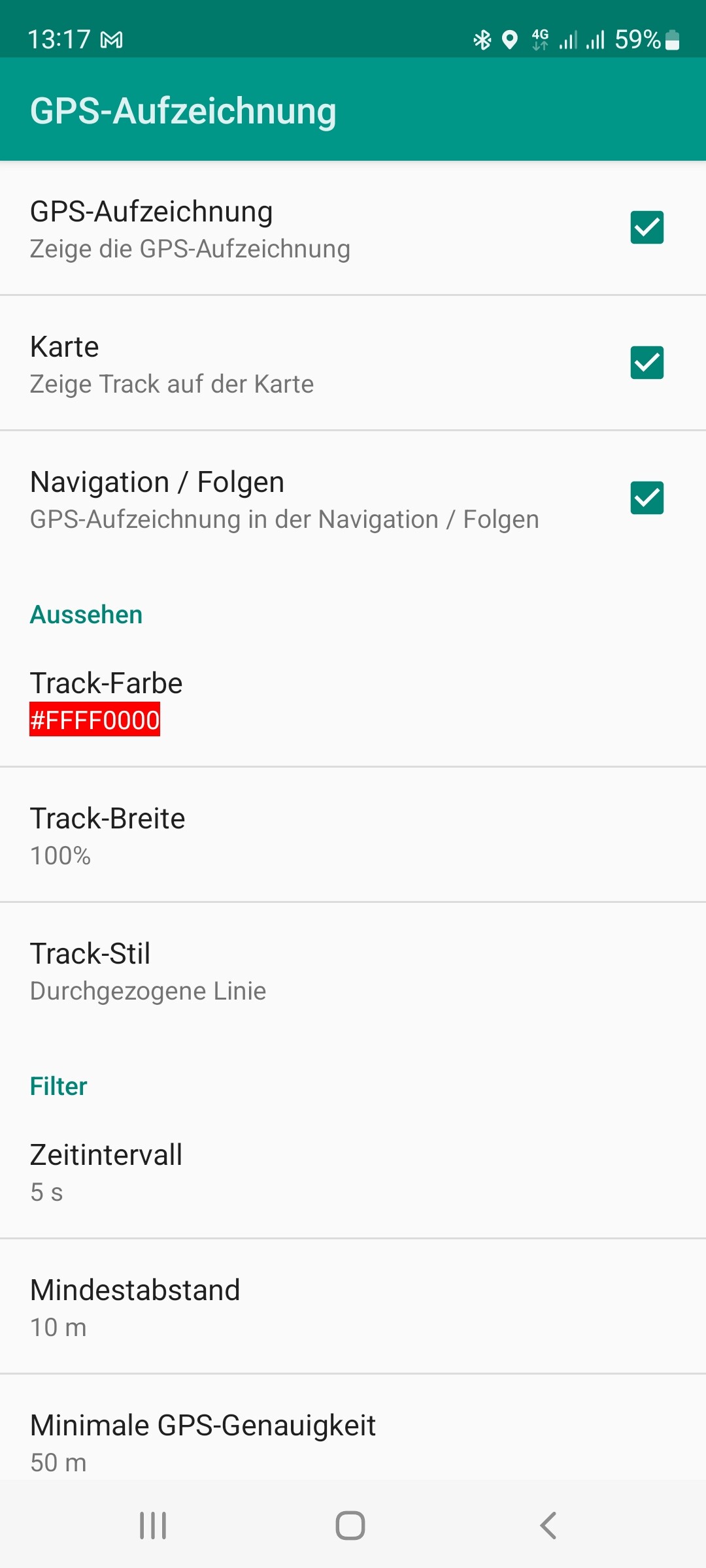

Did you set the track (and panel) to be visible in GPS recording settings?

Yes, I mean GPS recording. While driving it’s visible as a red line, as always. But when I close and reopen the app it’s gone.

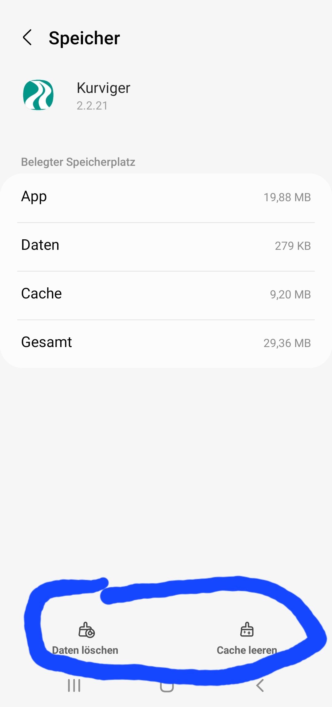

Clean install did not solve it. BUT I could manage the issue…
I had to delete cache and data in the android app menu. After that I did not loose the GPS tracks anymore
