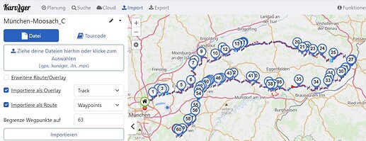

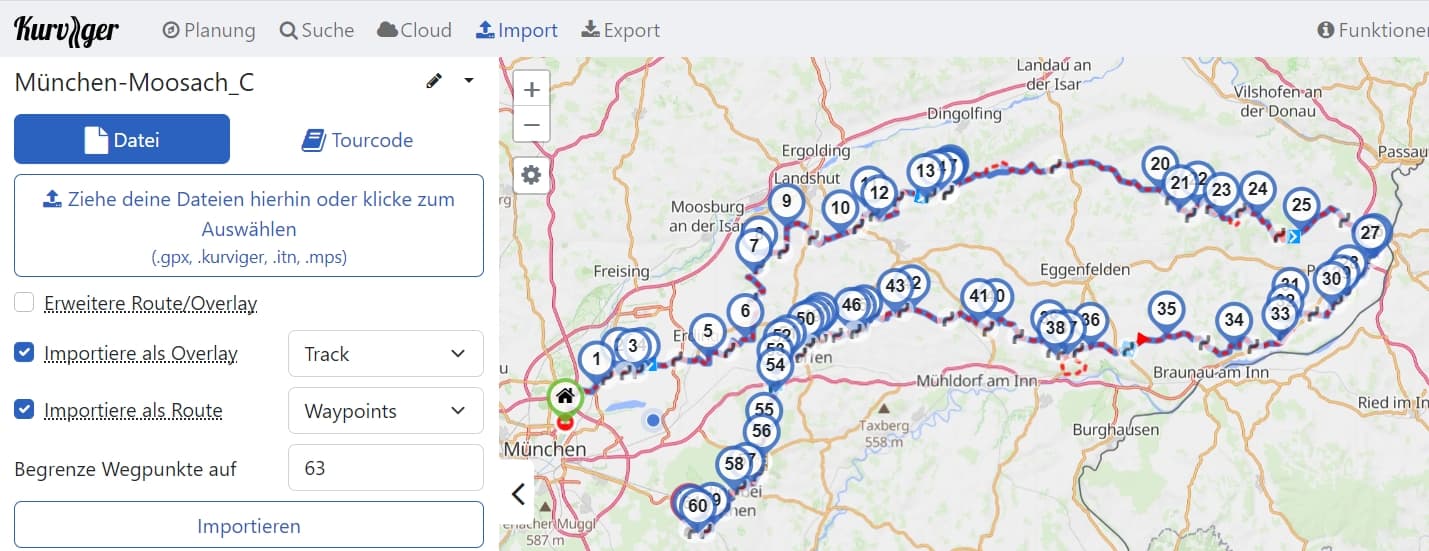

When importing, you can choose how track and route should be calculated: using the track, the route or the waypoint list. Here is a sample GPX file that contains all three components - not from Basecamp, because I don’t use that:
Munich-Moosach_C.gpx (359,4 KB)
If you now import with Track=Track and Route=Route you will get the desired result, I think. It is important to dose the number of waypoints correctly - ideally to the number of waypoints in your Basecamp file.

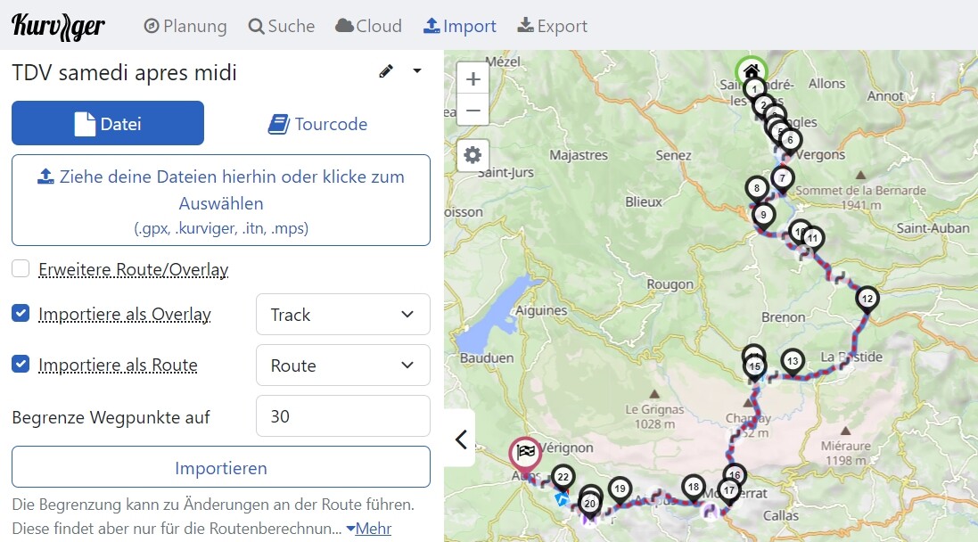

importing your file into kurviger.de works correctly - if you specify enough waypoints (in this case 30):
Here the kurviger-link https://kurv.gr/qdwxN as result.
The track is inherent in your file (a special dialect of GPX) but ignored by kurviger.de - I extracted the track and imported it separately as overlay.

now I got it! No - obviously kurviger.de cannot process the track data from your file at the same time as the route. As I said, I extracted the track and then loaded it as an overlay.
Something is wrong with your Basecamp output. If I load the file into RouteConverter and save it again, kurviger.de can process the new file (TDV samedi apres midi_RC.gpx (761,6 KB)) correctly.

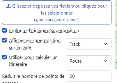

Hello ça fonctionne quand même
La meilleur façon de partager un fichier issu de Garmin Base Camp
et de régler en importation le Overlay en Track et l itinéraire en route .
j ’ ai testé différente façon de calcul , la route ne bouge pas et on la trace en vérification
