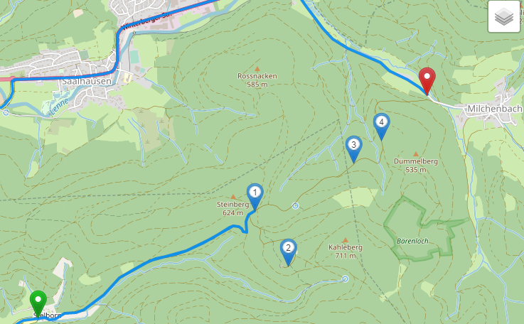

Hello, last week end I rode with my bike in the region Sauerland near Dortmund. I got a route recommended and it was great. It was a single lane route throw the forest. Unfortunately it was not possible to plan it with https://kurviger.de.
I found the sign “Land- und Forstwirtschaftlicher Verkehr frei” at the beginnig of the forest route starting in Stelborn with the additional information that the way up to the restaurant (Point 2) was free to ride/drive.
https://kurv.gr/YrrQ0
It was not possible wether to plan the route to the restaurant nor to the final target near Milchenbach.
Do you have an idea what is wrong in OSM? I looked at it but I could not find the problem.
Puh, there are many reasons:
Start to Waypoint 1
access=designated which should not be used and seems to be wrong anyway.
e.g. bicycle=designated would be “Fahradweg”
See https://wiki.openstreetmap.org/wiki/DE:Tag:access=designated?uselang=de
Waypoint 2
highway=track
AFAIK Kurviger needs an access Tag on tracks ?
Waypoint 3 and 4
access=agricultural
Meaning that this way is only for “Land und Forstwirtschaft”
Seems to be correct :shushing_face:
Manfred
I guess that the way to the Restaurant (Point 2) should be tagged
access=destination and
access=agricultural
The rest of the forest road is
access=agricultural
Manfred
Thank you, I addes the access=destination for the first part to the restaurant.
and I added the access=agricultural for the second part. But it is only possible to add one line with the same keyword “access”.
I will see what happend.
In the first part it looks like:
in the second part ist looks now like:
Hi @geishaus,
I think I was wrong. I am not an OSM expert. Looking at the OSM wiki the access tag is organized hirarchically.
So access=agricultural would mean “access only for agricultural usage”, even if you are on foot or bicycle. But that is not, what the traffic_sign=DE:260 is meaning.
So I think, a better tagging would be:
  • for the way to the Restaurant (Point 2)
    motor_vehicle=destination
  • for the rest of the forest road
    motor_vehicle=agricultural
And remove the general access tag
Edit: I have changed it now.
Manfred
Thank you very much for your advice. I looked at it again in OSM and learnd a lot.
Thanks for improving OSM data. If the way is tagged with access=destination, Kurviger will allow accessing it if you place waypoints on it. So it should work after the next data update :slight_smile:.
