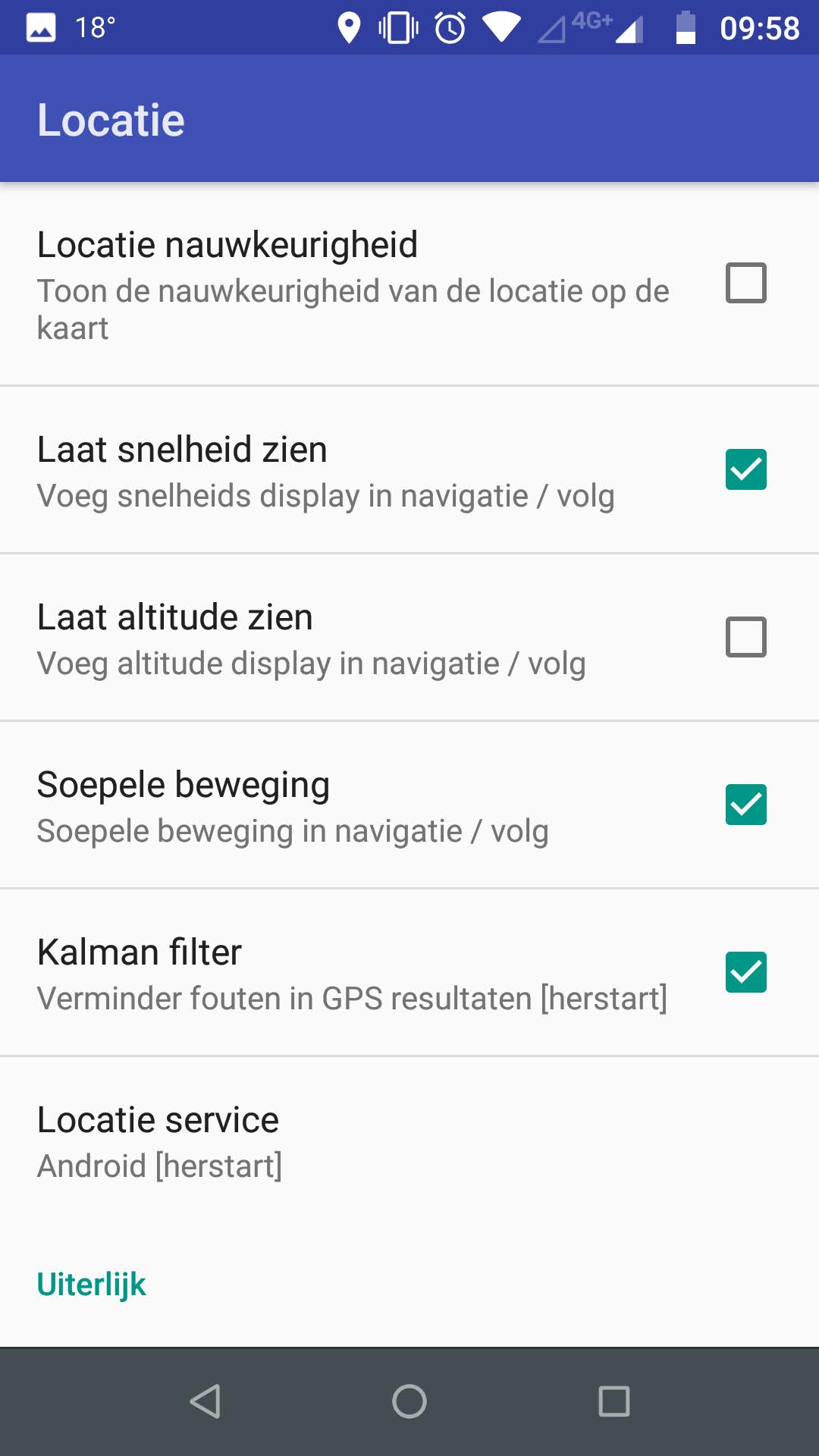

When I set the navigation to Android, like you pointed out before. The dot stays a dot and the navigation never really starts. Any idea where it is going wrong?

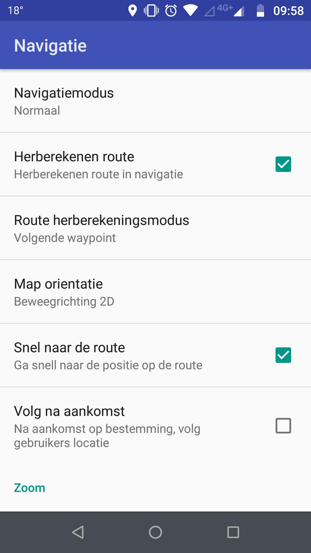

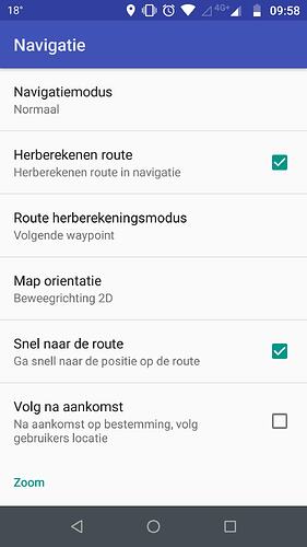

I will send you print screens of my navigation and location settings.

It’s always better to test with the default settings:
Location
- Disable “Smooth movement”
- Disable “Kalman filter” (and restart app)
- Select “Android” as location service (and restart app)
Navigation
- Disable “Snap to route”
Most important:
- Enable the GPS in the device’s Android settings
Navigation works with GPS sensor.
GPS provides the location and direction (arrow) when move outside.
