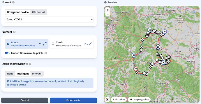

We are excited to announce an updated export function which allows you to effortlessly choose the optimal format for the most common navigation devices. You can visualize where additional points are placed along a route and select from multiple waypoint placement strategies, giving you greater control over route accuracy and performance.
In response to community feedback, we’ve also added a dedicated export option for Garmin devices, ensuring that routes are transferred exactly as planned. You can enable this by choosing the option “embed Garmin route points”.
And for even greater flexibility, we now support the import of KML files, enabling users to bring in routes from a wider range of platforms and tools.
Explore the new features now on our website and soon in our app.
Here is a quick preview, please let us know what you think about the new export :motorcycle: :smiling_cat_with_heart_eyes: :racing_car:
