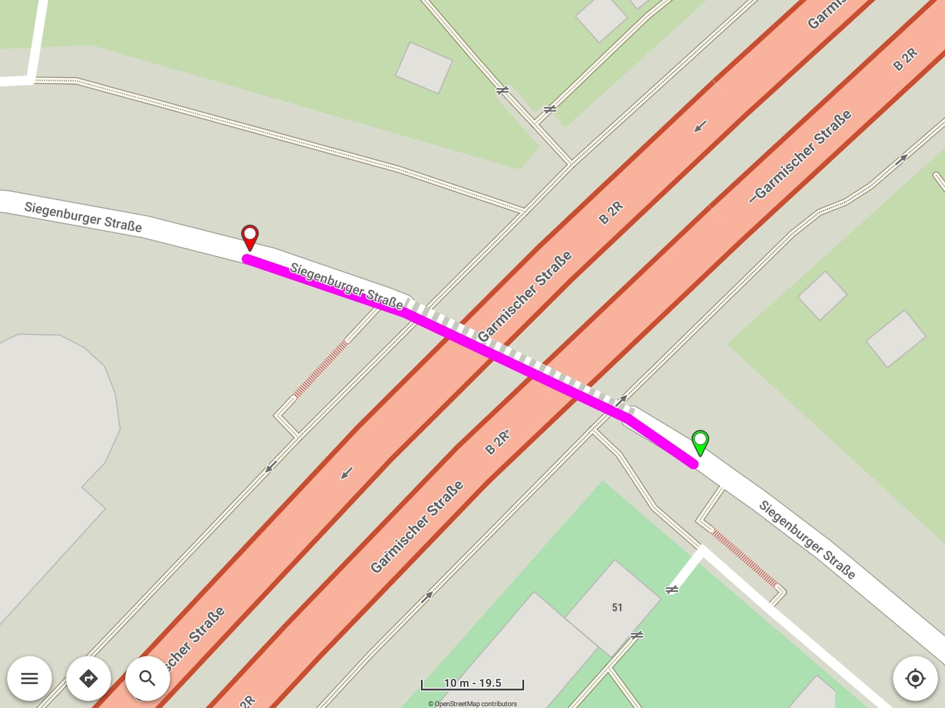

Sometimes crossing roads with tunnels or bridges are shown in wrong order - the wrong road is on top.

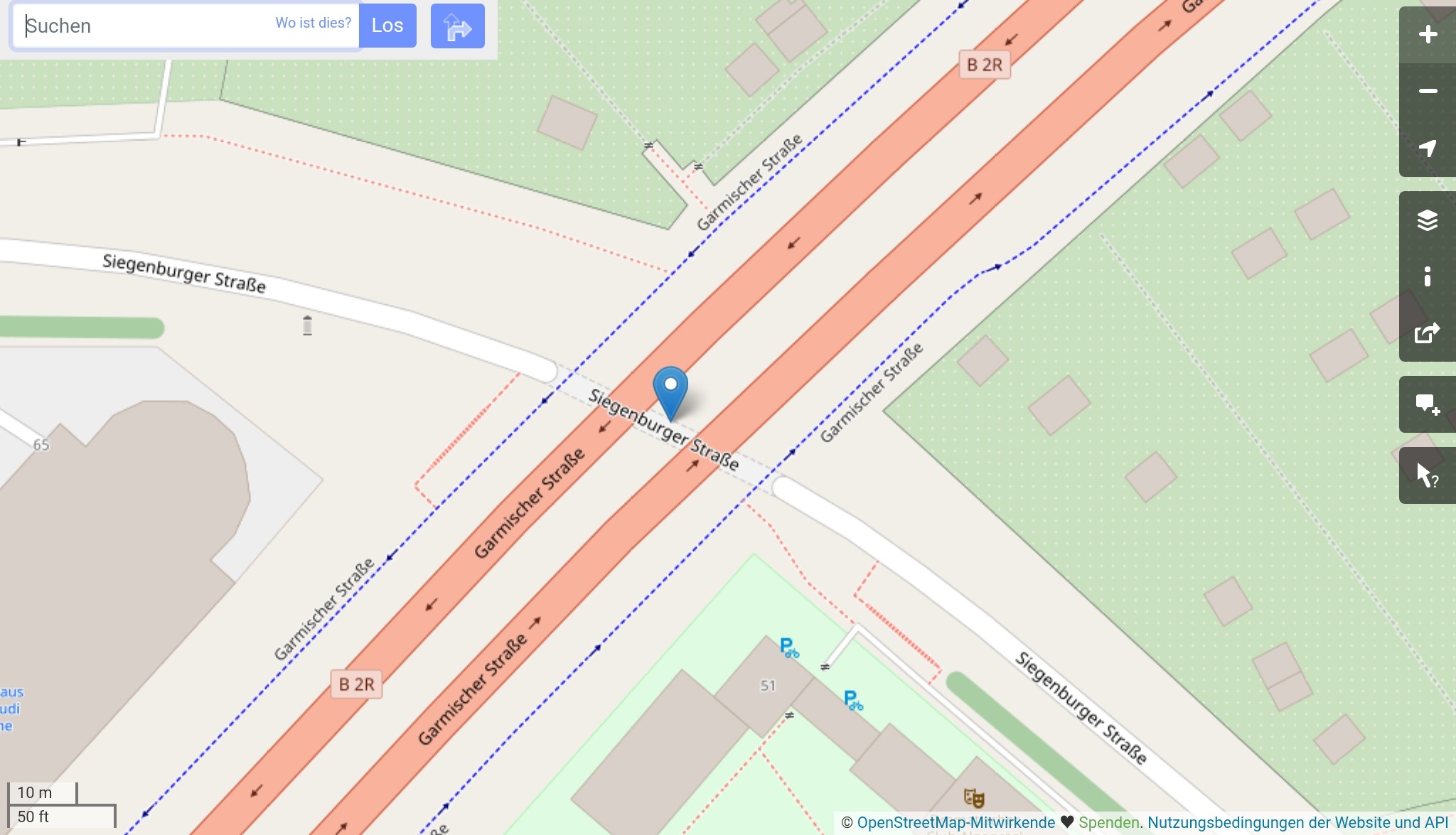

As far as I can see, the OSM data is correct.
Example: https://kurv.gr/dXCYM
Further examples:
If useful I can provide further screenshots.
I opened only the germany.map (just downloaded → up to date). I use the internal map style.

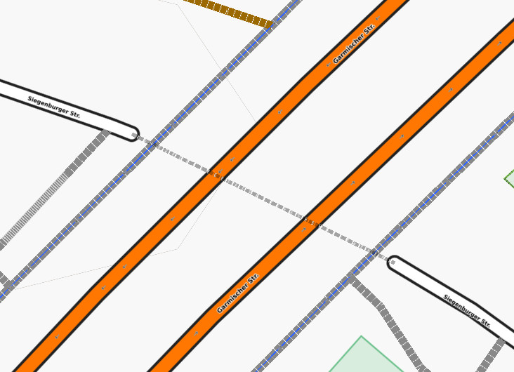

Changing to an other map did not help (neither bayern.map from Kurviger download server, nor from OpenAndroMaps).
But opening style from from OpenAndroMaps lead to success: The tunnel was always below the road, indenpendent of selected style (Elements.xml or Elevation.xml). :+1:

Quick update: checking OpenAndroMaps and Elevate,
tunnels have dashed line and layer is not below roads.
