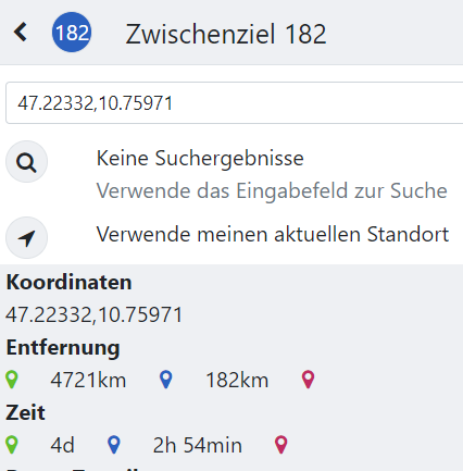

Thanks for the proposal and the nice words.
Have you tried working with:
a) Left click on a waypoint on the map. This shows you the distance information of that waypoint.
b) Use the elevation diagram in the bottom-right. You can move your mouse over it and see where this point is on the map, this can also help to estimate the distance.
To be honest, I would like to avoid making this more complicated by introducing more buttons and columns for this :slight_smile:.
Understandable.
The thing is: when I click on a waypoint, I get the distance&time from the starting point of the whole trip - which was in my case 5 days ago.
Im looking for the „Tageskilometer“, distance travelled just on that day.
But yes, therefore kurvige needs to know on which waypoint I had an overnight stay resulting in another button.
Same goes for filtering out the turning points from the roadbook, to have a exportable overview of the whole trip.

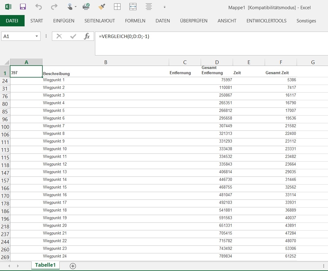

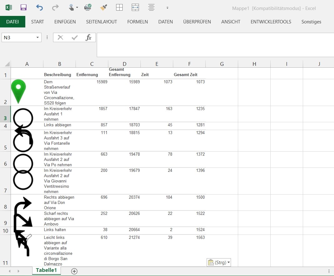

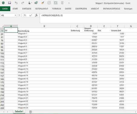

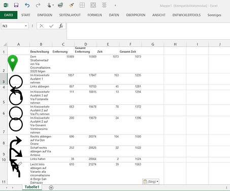

@Pete I can help you with filtering the waypoints - here is an Excel macro kurviger.bas.zip (620 Bytes) which does exactly that. The macro is called “kurviger” and can be called with CTRL-k. You have to extract it to kurviger.bas and import it bei ALT-F11 in Excel.
It first kicks out the annoying turn graphics, puts everything into a single-line format, and determines the number of records. Then it hides all the lines that don’t contain a waypoint. The latter I recognize by the fact that there is no “single distance”. Unfortunately, the waypoint names are not transferred to the roadbook today. The further formatting in kilometers and HH:MM I leave to you - there everyone has probably his preferences.
Here the before and after screenshots:
@zaphod_42 brilliant, works like a charm, thanks! That actually makes it a bit easier, although you still have to repeat the copy/paste export + makro execution after each update to the route.
But also shows that I’m not the only one looking for a “waypoint only” overview. :wink:

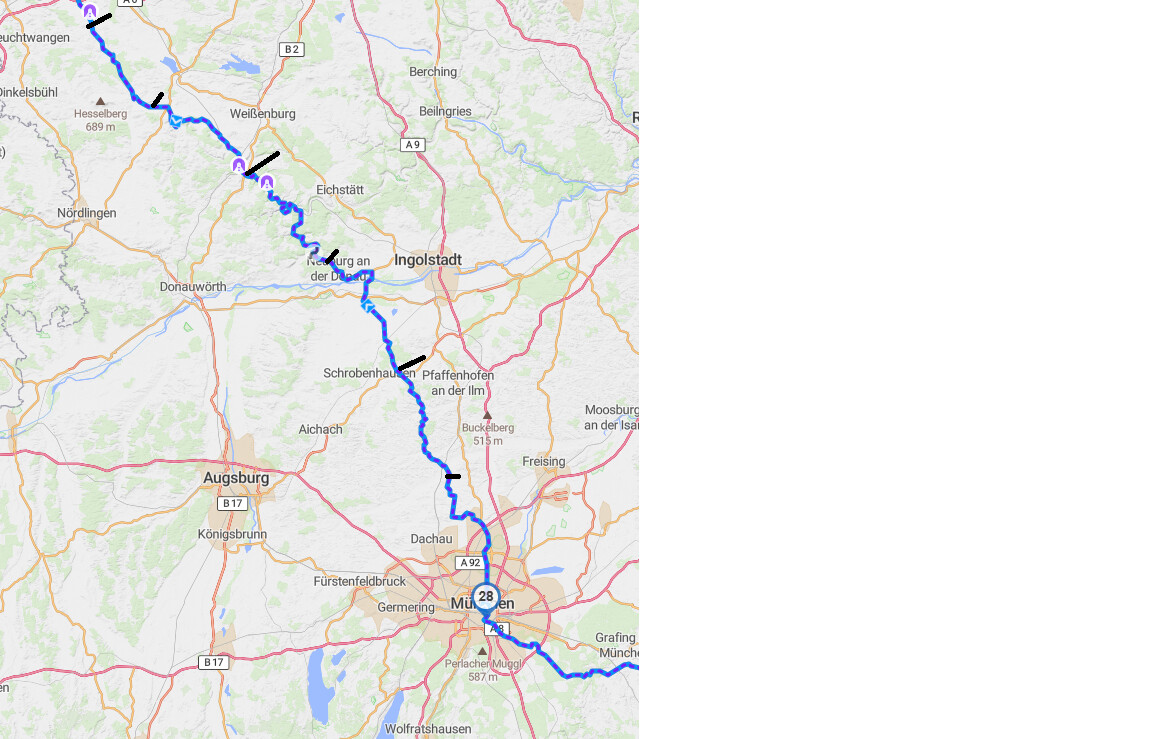

I spend some more thoughts on how this could be supported a little more - even though I could work around it with your guys advice and help (thanks for that again). So, please take this just as a brainstorming idea:
To visually support that its time to plan a overnight waypoint whithout having to introduce another button, the route itself could have a short marker for every 25km and a bigger one for every 50km from the last waypoint (or something similar).
So the userstory would be: I change the non-overnight waypoint to shaping-points and then count the preferred number of markers (depending on my appetite for distance, POIs, breakfast etc :wink: and there I look around for a hotel/campsite.
I added a (poorly made!!) scribble to make it a little clearer.
What are your thoughts on this?
Thanks fot the discussion
Best
Pete
That could make sense and could help to get a better overview of the route.
What do others think about this?

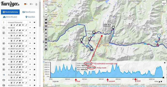

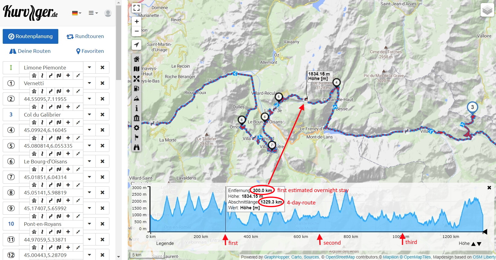

With 25-/50-km indicators, I think we overload the route. Perhaps a 100-km index would be a compromise.
But anyway: I don’t need to count along this “string of pearls”, because it’s already possible to determine the distances - with the topography diagram. Example:
Since at exactly 300km no hotel will be found, we simply take the next larger town and start the search there. Once the hotel booking is made, I set an intermediate destination at the hotel address and split the route there. After three splits I have my 4 day tours.
Who wants to try it “live”: https://kurv.gr/KU97F

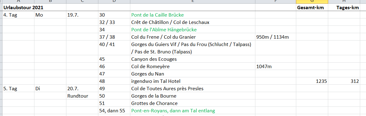

I want to continue or restart or vote to this topic of pete.
Actually I’m writing my own roadboak in excel with the planned date, number of waypoint, name of waypoint, , in case of passes also the height, daily km, complete km of the route.
For the ca-planned hotel I’m using a personally named waypoint where I want to stay overnight (ca +/-km). Since the naming of waypoint is possible I don’t need any separate waypoint-function for “hotel” anymore.
But a shortened roadbook to excel or whatever would be faster and easier :slight_smile:
My problem with the roadbook is that on tour I want to “cut” the route day by day, the splitting function is very usable. So all “used” waypoint of driven route could be eliminated.
BUT in case of new starting or splitting a route all numbers of waypoints are numbered, starting with 1. So my excel-roadbook for the complete route is not correct anymore and it’s not easy not to loose the overview what was planned. Is there any possibiltiy to do it another way?
In former times the planned route was shown in the app (in blue), and everything what was driven was removed (and only documented by the red track). So it was easily possible to orientate what was “old” and what’s coming new. In this case it would be possible to use the full route day by day. Is there any way to do it similar today?
(is this a plannung function of website or routing funcition of the APP?)
