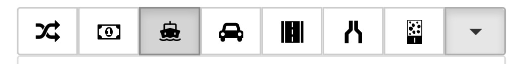

After toggling the buttons in advanced options, it is difficult (or not possible) to see the status, because the button stays the active element afterwards.
I saw this effect with Google Chrome App 86.0.4240.198 on Android 7. I am logged in as a “Kurviger Tourer”.
Ferry on: image
Ferry off: image
Ferry off after clicking on another button (“Place WPs on route”):
Therefore I propose to remove focus from the buttons ofter clicking / tapping ( element.blur() ).

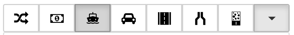

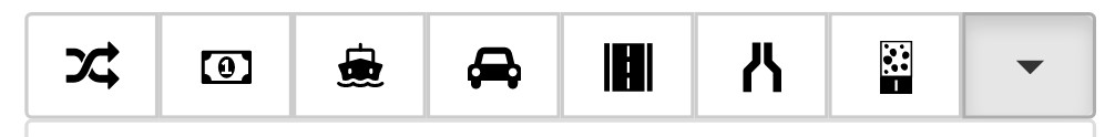

I have just tested it. Although I cleared the browser cache, there seems to be no significant change:
Ferry on after tapping button:
Ferry on after tapping elsewhere:
Ferry off after tapping button:
Ferry off after tapping elsewhere:
It seems that the button still has the focus until I tap on an other button or somewhere else :thinking:

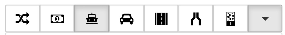

Unfortunately it’s not 100% perfect, but if you compare it to your fist screenshots, it’s already a lot better :slight_smile:?
Hmmmm - perhaps the order in my previous post is not optimal.
Comparing “Ferry on” with “Ferry off”, both directly after tapping button, I still can not see a difference
