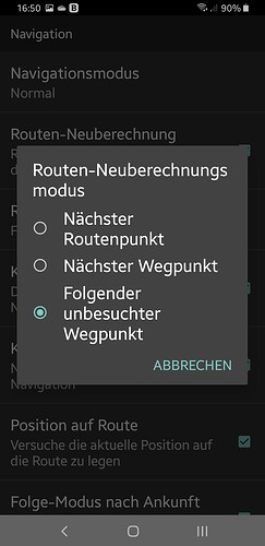

unfortunately Kurviger still can’t manage correctly if a round trip contains crosswise routing. Even if the setting in routing mode is next unvisited waypoint, this doesn’t work.

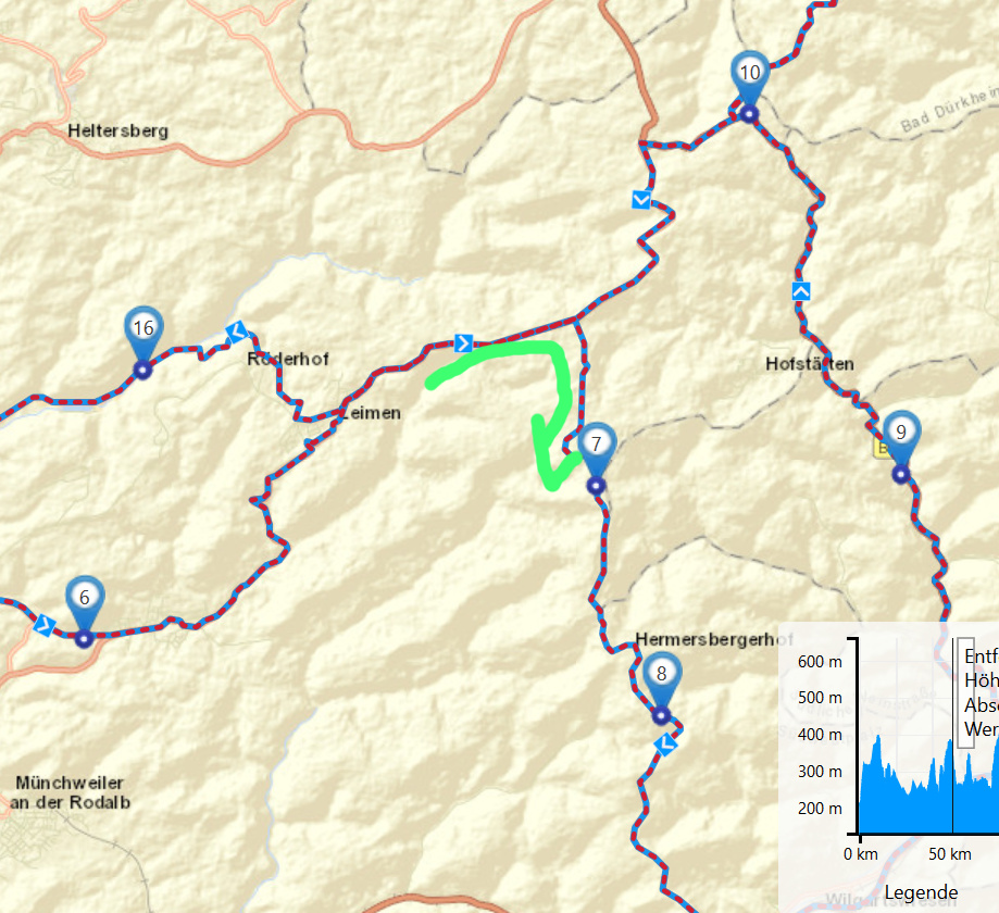

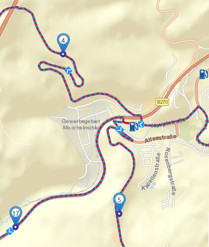

Normally Kurviger should guide from wp4 to wp5, but as soon as it reaches the cross-over, it guides to wp17, thinking I am on the way back.
Instead of guiding from wp4 to wp5 (green arrow), it guides to wp17 → 1st problem

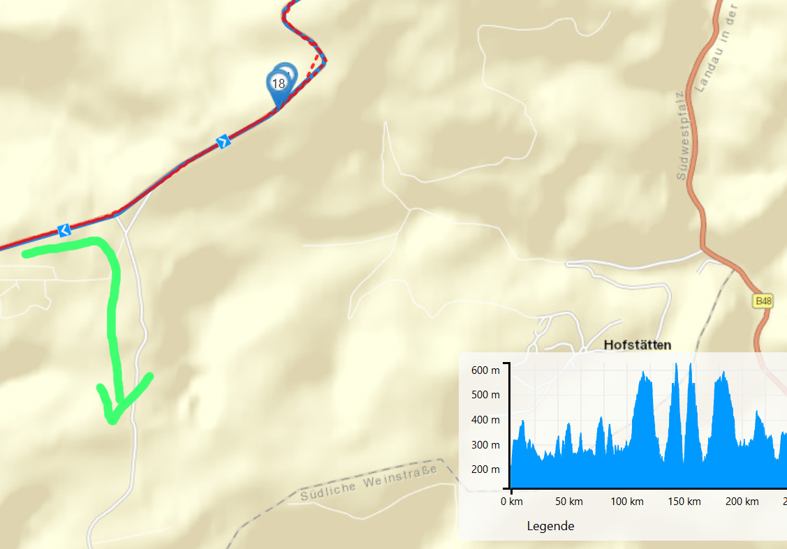

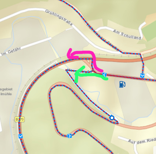

When starting to turn around and driving to wp5 (= wp13 in the track), it suddenly deletes all wps from wp5 to and including wp16, which means my complete route is lost → 2nd problem
I had to stop and re-import the planned route… but it doesn’t brings me back to wp5, because it has “forgotten” that I had already visited all wps till wp4 -->3rd problem
I should have deleted all previous wps? A mess without proper spectacles.

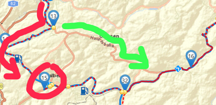

The consequence was that it routes me to a new destination (maybe it thinks wp1 would be my next wp) and I lost my complete path. Green Arrow was the planned route.

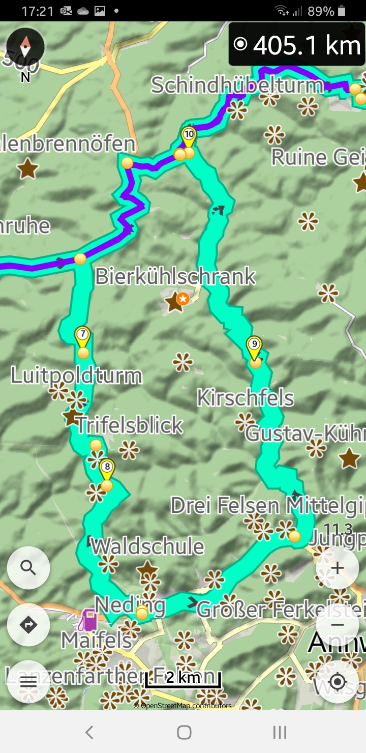

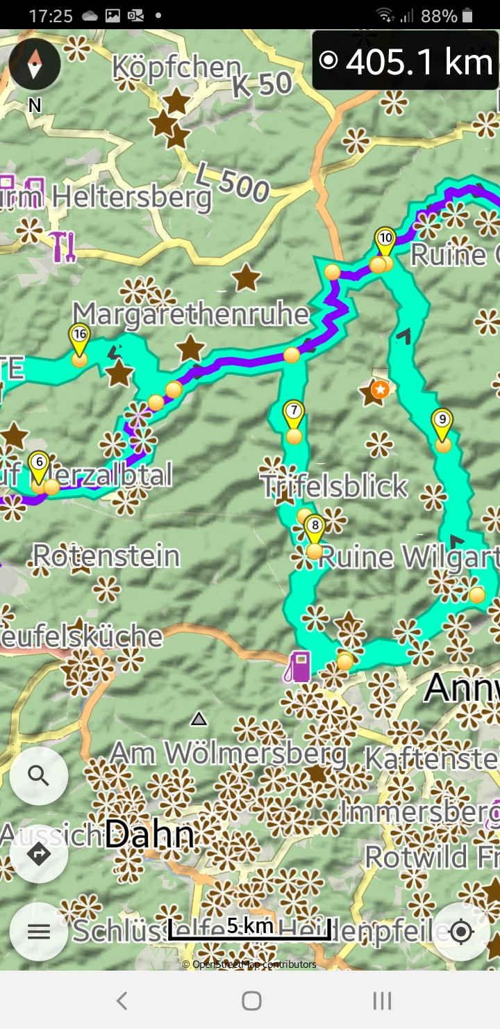

Further on the route after I have found again the way by manually deleting wps (which was alone very bad because 5 bikes behind me were waiting until I sort out the app problems), it completely ignores a big beautiful round

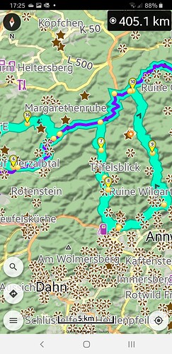

Instead of guiding from wp6 to wp7, it directly took the way to wp10, completely ignoring wp7,8 and 9. This is really not what I am expecting when the setting is “routing to next unvisited waypoint”. It simply doesn’t work.
Kurviger should simply KEEP the sequence… also when the route contains crosswise waypoints… after wp4 there is wp5 and not wp17!! And after wp6 the next wp is wp7 and not wp10!! And it should keep knowing the already passed wps when I have to reload the planned route because Kurviger unattendetly deletes wps.

What I think could have happened, if you missed the left turn to WP5, the navigation continues towards WP17.

Rerouting works as was agreed with users when was designed.
Being flexible so can exit and enter the route freely at any point.
Its options are certainly not as mentioned, they’re quite different:
  • Nearest point on route: nearest coordinates on the route path (not waypoint)
  • Nearest waypoint: nearest waypoint (via points, destination) of the route
  • Next unvisited waypoint: next waypoint (via points, destination) that has not been passed yet
    (flexibility currently allows to pass / skip freely and automatically any waypoint)
Extra options may come in the future with strict route following:

Even if I had missed it, with routing option “next unvisited waypoint” it should recognize that I have missed the direction to wp5 and send me back to wp5 instead of further route to wp17. Wouldn’t you agree?

Same here for this willingly planned detour… even if I have missed the turnoff to wp7 (human beings are not mult-tasking capable :slight_smile: ), I would expect the routing engine to guide me back to wp7 instead of heading to wp10. Again, with the option route to “next unvisited wp” everything else makes no sense to me. In such an option any deleting or skipping waypoints shouldn’t happen.

Sure, but I doubt that this was the reason here.
No, you left the route shortly before WP17, to me it would make that Kurviger would reroute you to WP17. You skipped Waypoints 5-16. If you had done this intentionally you would complain that Kurviger is not rerouting you to WP17.

probably this happened… probably Kurviger guided to turn left and I took the magenta left instead of the green left
But no, I wouldn’t complain if Kurviger would not route to wp17, not with the “next unvisited waypoint” mode, since I thought this would already be the strictly follow wps in sequence mode… obviously it is not (just learned 15 minutes ago).

But it doesn’t, see track picture. According to my planned route Kurviger should have taken the direction of the green arrow
this was the planned route. Kurviger completely skipped wp7,8 and 9 without telling to turn right.

I understand your problem description. But I can’t reproduce it. So I can only guess why Kurviger didn’t tell you to turn. At that point you already started to change your planned route.
