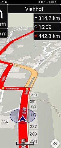

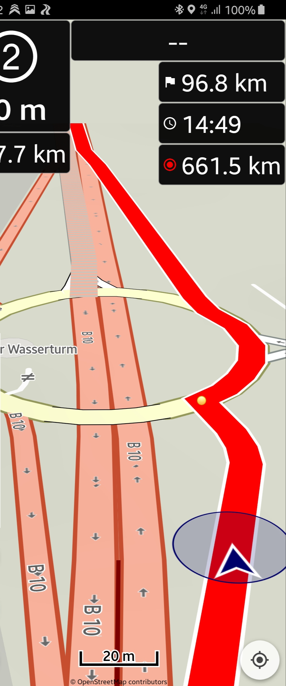

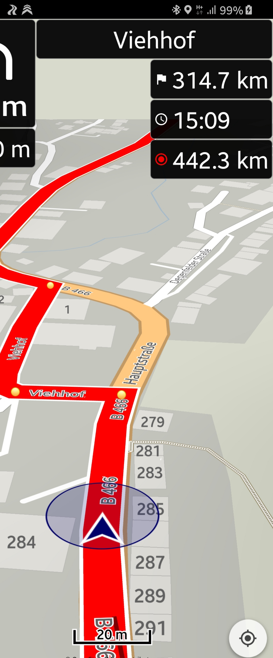

Can these strange exits from the route be avoided? The calculated way should use the main road when this is the only “natural” road.
I have used quickest route option this time, but this should be avoided in any case.
Furthermore on the top of the screen there is a free space which maybe should simulate the horizon, but it is wasted space in my point of view, because the driven route is cropped there. Why not let the actual route last to the rim of the screen. Actually this space is hidden by the navigation bars with big font size in my screenshot, but when the font size is smaller this lost space is even more unnecessary.

Seems like a GL regression on very high resolution screens.
I can adjust the map tilt better, improving such corner cases.

Strange Routing 1 is obvious:
There is maxspeed=30 on the main road, and no speed limit on the residential.
So probably missing or false data in OSM. To change this you would need local knowledge.

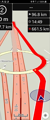

Strange Route 2.:
There is a speed limit of 90 on the main road, and again no speed limit on the side road. :thinking:
