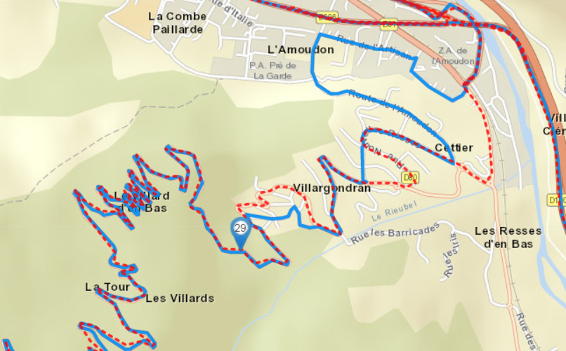

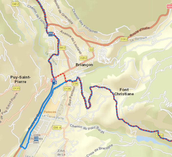

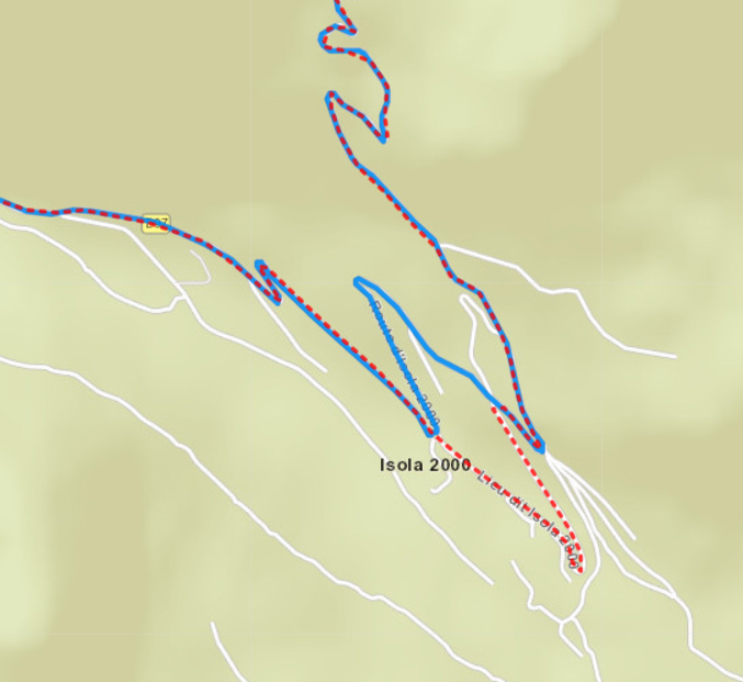

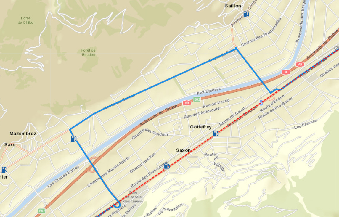

For sure I remember, that last year (or in 2017) someone of the admins pronounced, that the routing in villages was optimised to reduce unnecessary kurvy streets. But this year it seemed to me that’s more worse? Perhaps its because of the quality of the road information in OSM in CH-F-I?
I’ve added some example - I don’t know if someone want to check everyone.
And I don’t know how to add more information to find the correct scene, therefore additional information concerning the “general” route:
Nr. 1: route Andermatt → Martigny

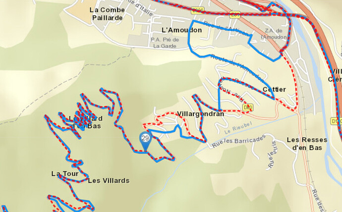

Nr. 2: Saint-Jean-de-Maurienne (ouest of col de telegraph/galibier: here we followed the “normal” route with serpentines, not shortening the route

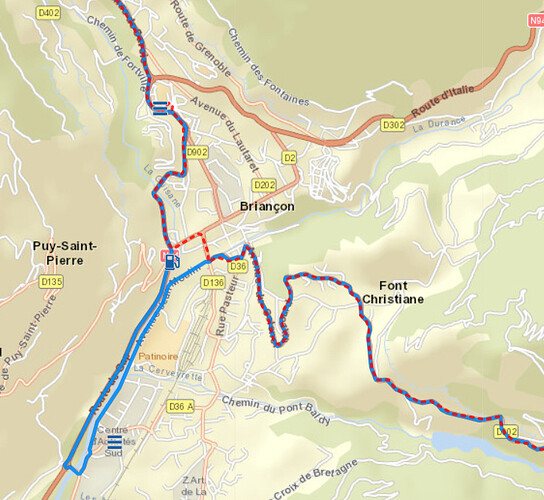

Nr. 3: Briancon: it’s not necessary to go the long route and turn around. There is everywhere allowed to go straigth through the city
Nr. 4: Isola 2000: the planned route is only allowed for residents, our trip was the “normal” road through this village

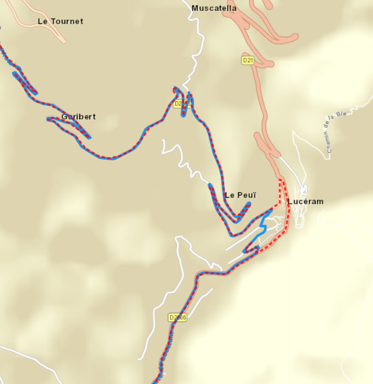

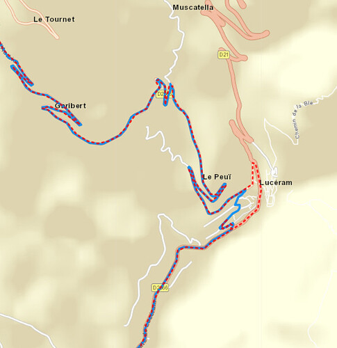

Nr. 5: Luceram, that’s in the south, near Monaco/Nizza

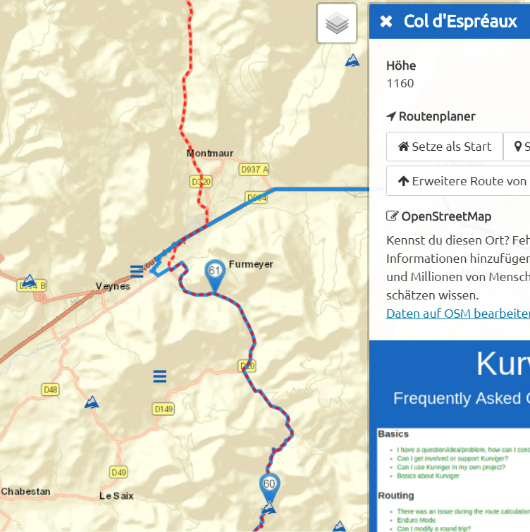

Nr. 6: Furmeyer is in the ouest of GAP

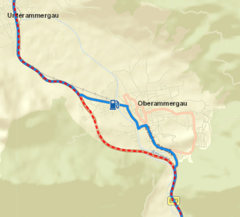

Nr. 7: Oberammergau - that’s easy :slight_smile:
Have fun :slight_smile:
BR juschka

Nr. 2: https://kurv.gr/4kfe7
Nr. 3: https://kurv.gr/9xcDP

Nr. 5: https://kurv.gr/9S14Q
Nr. 6: https://kurv.gr/1LlZ6
Nr. 7: https://kurv.gr/4kKIe

Hm, a lot of those examples are not inside villages if I see that correctly. Would you want the algorithm to follow the main road more just in general? I don’t think the devs can do much to make kurviger stay on those serpentine, hairpin-bends from your examples more, without breaking lots of other stuff. How would kurviger be supposed to know that it needs to look for extra curves sometimes and sometimes not :thinking:
