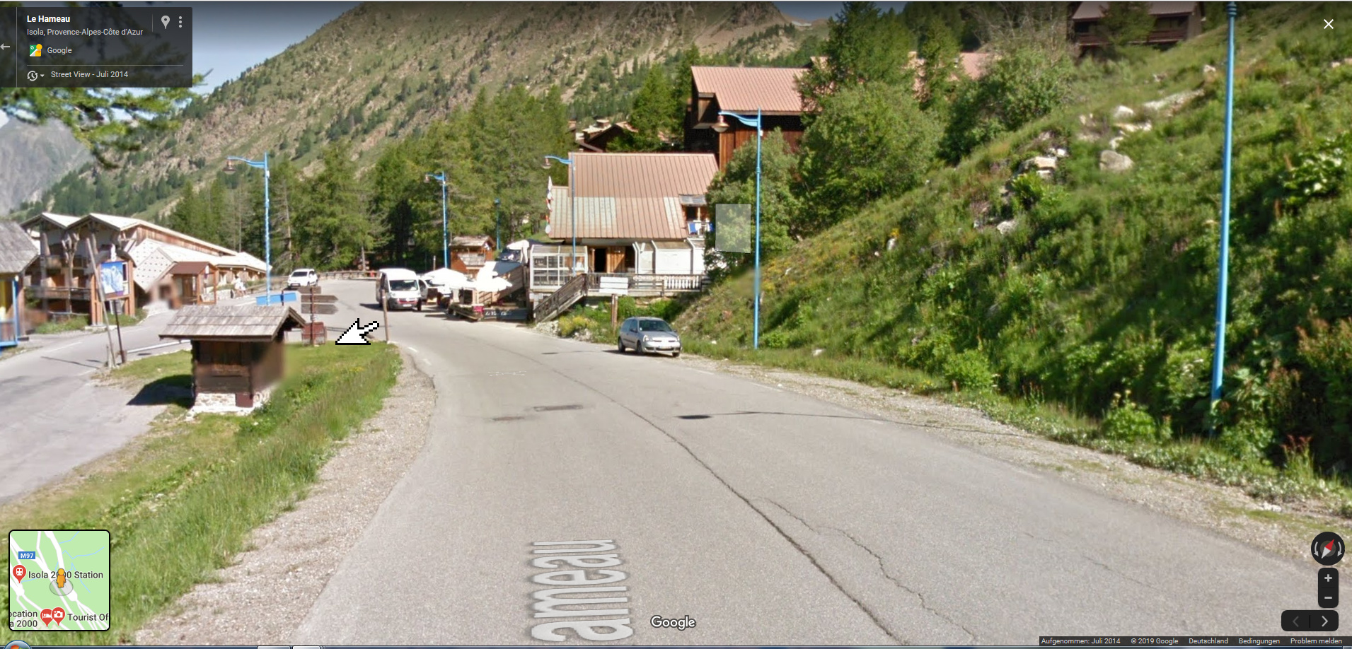

Here as example Isola 2000 as google maps photo:
We’ve used the mainroad to the left (turn), kurviger wanted us to go straight ahead
You see there is free space for at least 3 cars on the road…

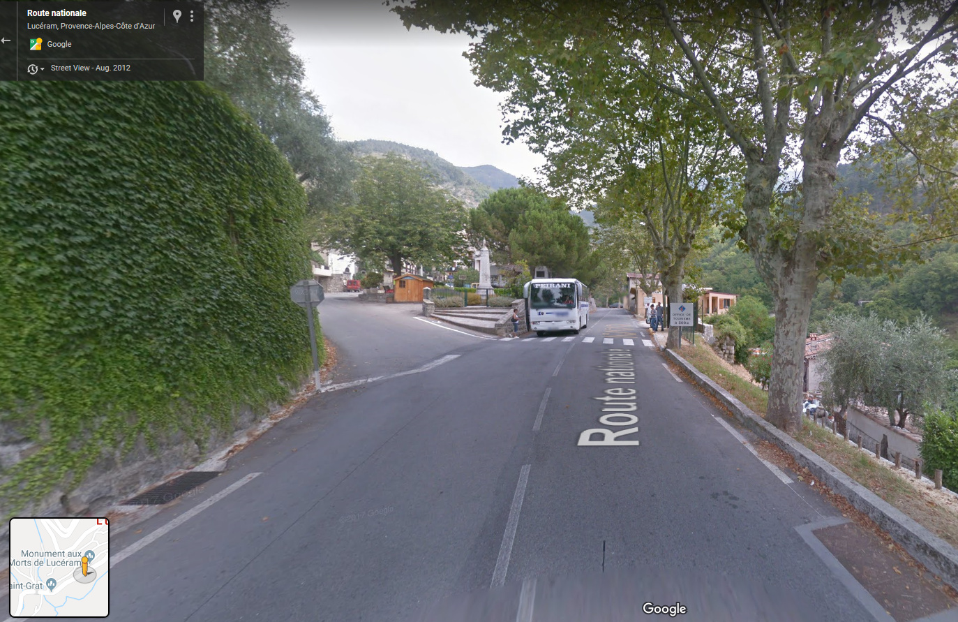

Here is the situation in Luceram. Kurviger wanted to leave us the road to the left to the smaller road before the bus. The main road is not really small… and its also curvy (turn around some meter later)
The sign of the village is about 100m before the situation on this photo:

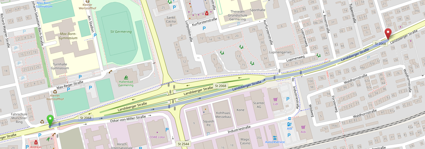

Thats’ the reason why I’m normally “avoid small roads” because then Kurviger avoids small up and downs on different roads. Sometimes he don’t know if a road has only a “Abfahrt” or “Auffahrt” or is a special roundabout -route. In unklnown regions it’s sometimes hard to detect such “mistakes” and avoid such curvy roads :slight_smile:

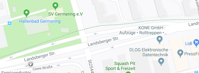

Here for example Germering near Munich, Landsberger Str. - you see the planning (curvy route, avoid unpaved roads) and the real tracking (for sure straight forward)
Here on google maps:
Germering Landsbergerstr
For sure I don’t know what to do in programming the software, for me it seems hard to optimize it :slight_smile:
Thanks for the example @juschka10001. That’s a good example of incomplete/incorrect data @Patrick.
The main road is cluttered with all kind of details and tags. The linking road is not tagged as secondary_link (as it should be) and has no max speed. I am quite certain that if the tags for the linking road would be improved, Kurviger would route correctly at this point.
The same happens also for the default routing on OSM.
OK cool, so we kinda conclude that (in most cases) nowadays when we find something like this it’s a problem with the tagging (and could be reported here and/or fixed in OSM)

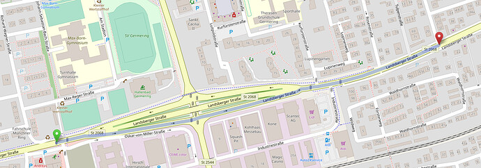

I updated the OSM data, please let us know in about two weeks if the issue was fixed :slight_smile:

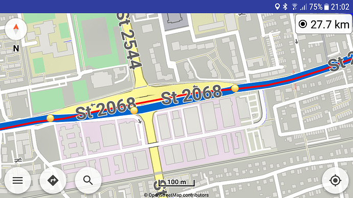

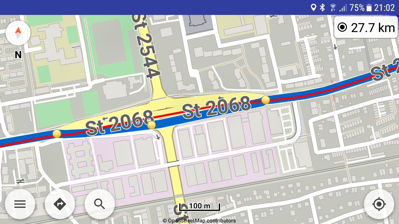

Today I’ve checked the OSM change in Germering as boldtm mentioned nearly 2 weeks ago.
That’s the result
Germering main road failure
It’ ok now :+1:

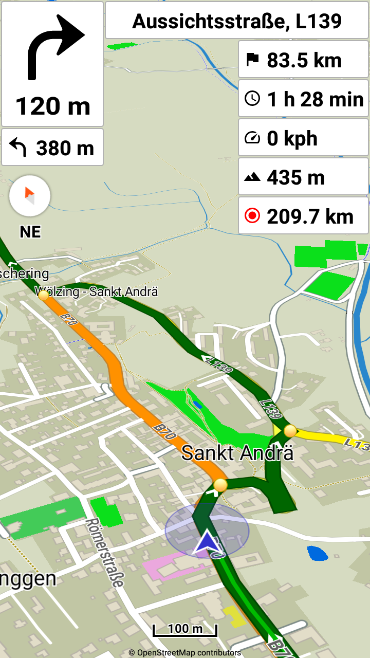

Fortunately, the 3D view sometimes helps in detecting the unwanted detour as can be seen in this screen-shot.
On other occasions I was less lucky.
==> Is there a way to improve this situation? Could there be a rule, which avoids leaving and re-entering the very same road within a certain (small) distance?
