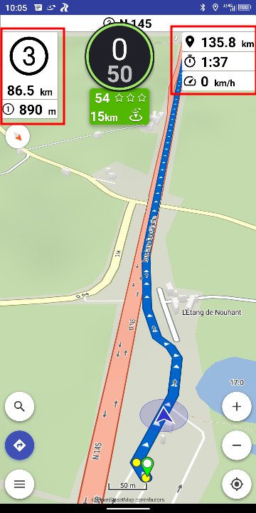

Is it possible to configure the data framed in red below?
Thank you in advance for your answers!

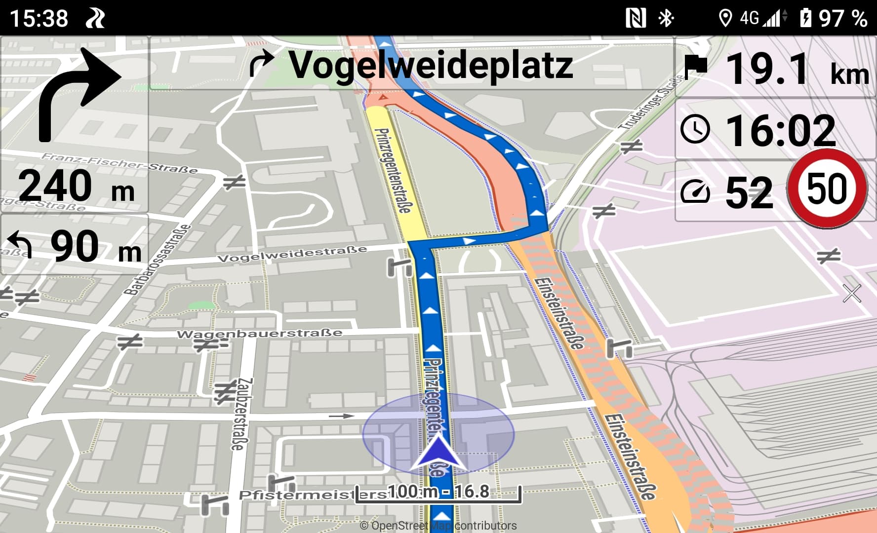

There are various parameters to change the look of the Kurviger App - for example mine:
If you like it, here is the corresponding .pref-File (in .zip archived): my_Bike.zip (1.8 KB) - you can use it as starting point an modify it as you like. Just read the online manual: https://docs.kurviger.de/

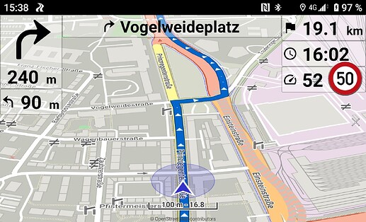

A new improved appearance for the navigation user interface exists in Kurviger 2.
You can change the background / icon / font colors & outline of the display panels.
Including speed limit display.

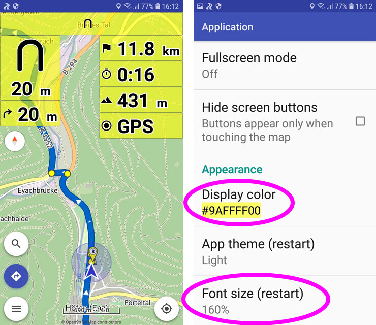

You asked for configuring the navigation panels. No fear, it’s easy to configure it even in Kurviger Pro 1.x. As described in the manual (link see in earlier post) you can modify the settings.
Here an example. You see appearance and the settings (Menu button > Settings > Application) for this:
Similar to this example in the Application Settings you can modify Display color (including transparency) and Font size according to your preferences.
When modifying Font size a restart of the app is required.
