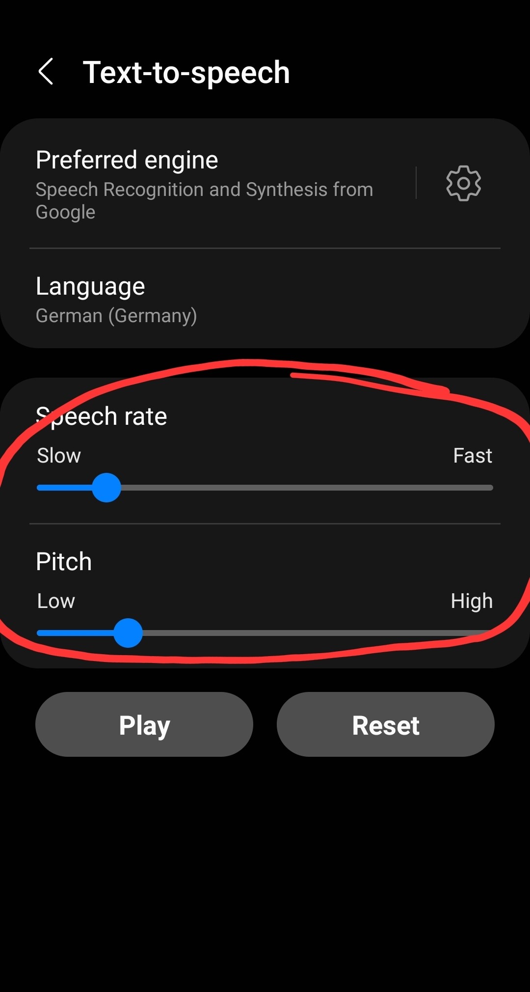

On my Samsung S10e (Android 12), those settings can be found under Text-to-speech settings, so look for something similar:
Thanks all! Fixed! :grin:
