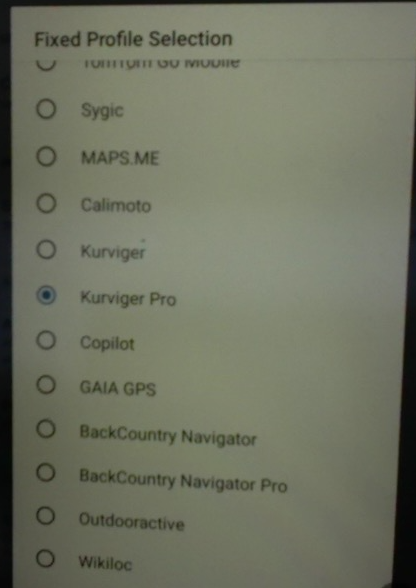

Thank you for the answer, I use the “Kurviger Pro” setting in the Carpe Iter controller, in automatic mode, the zoom buttons are not working at all.

No, in Kurviger Pro mode, the joystick only works for sliding, smooth on my Oneplus 8T and worse on my Galaxy Active Tab
Have you tried disabling this? I am not sure what the Kurviger Pro mode is?
In the Carpe Iter App, if I disable the “Automatic Mode” , I have to select an “App Profile” as you see in the picture. If not mentioned, all my posts refer to this mode.

A friend of mine tested this and he was able to get this done with the driver app installed. He mentioned that he just disabled the automatic mode.
Isn’t there the option to not select a profile at all?
No, as I see, there is no possibility, see the radio buttons in the screen in this thread, but anyway, I am quite fine with this now!
