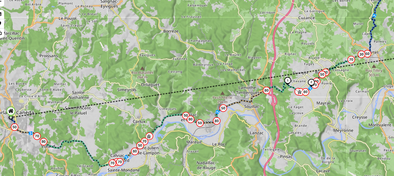

I’m planning since years and transfert the gpx file to my Tomtom 550.
It’s the first time I have a big diffenrecies regarding the total time of the planned route between my Tom tom and Kurviger. The number of kilometeres are the same.
I have also checked the road points per points without differencies
Kurviger shows me 474 km for 8h30 minutes.
Tomtom shows me 474 km for 7h07 minutes.
Below the kurviger link
Any idea why ?
Best regards

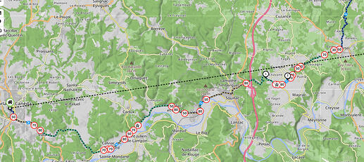

When I use your route and transfer it to TT 550, I get 8 hours 14 minutes and 475 km.
I haven’t superimposed the two routes, but I’m happy with my result.
What did I do?
I exported the Kurviger route as a GPX file with regular waypoints (every 7 km) and imported it into www.plan.tomtom.com. This creates two routes:
a) the fastest 476 km 7.08 hours
b) the exact route.
I always synchronise the exact route.
However, I must admit that otherwise the export in this way has always resulted in only minimal discrepancies, with a maximum difference of 2 km and a maximum time difference of 5 minutes.
My concerne is about the transit time in Kurviger.
Pretty sure the 7.08 hours are right. I have also uploaded the Kurviger file in Libertyrider and get also near to 7.10 hours as in Tomtom.
I cannot understand why Kurviger tells me 8.30 hours.
There is no speed limit on some roads. This could be one reason.
For other reasons take a look into this.
There are several other posts about time differences. Please use the search function at the top right.
