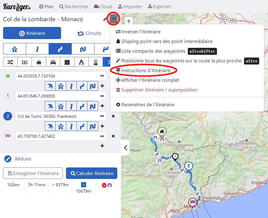

Creating a Roadbook using Kurviger
It’s quite easy …

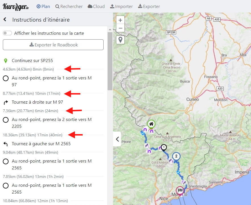

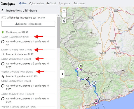

Take this Route (for you in France :wink:): https://kurv.gr/9PBst
The result:

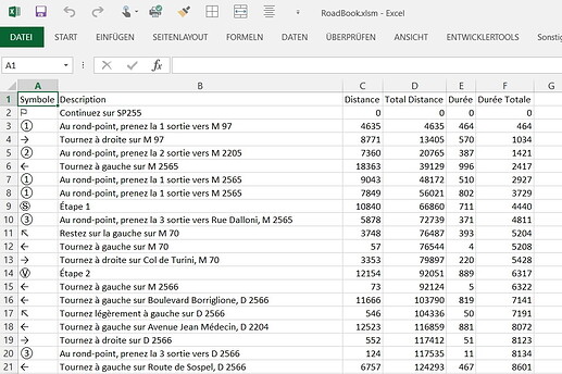

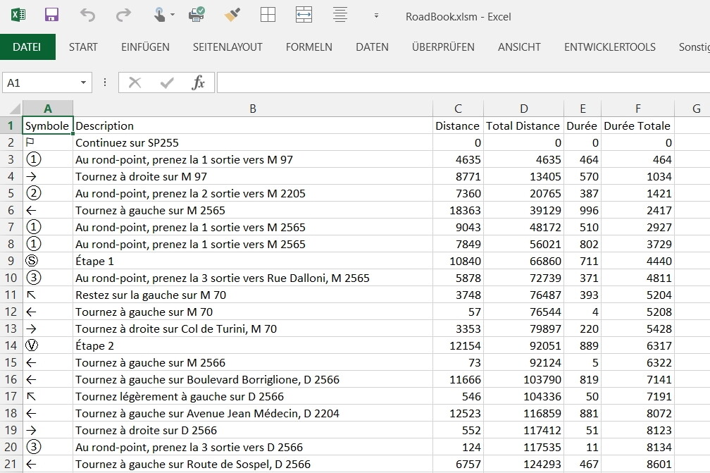

The same after imported into excel:

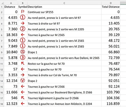

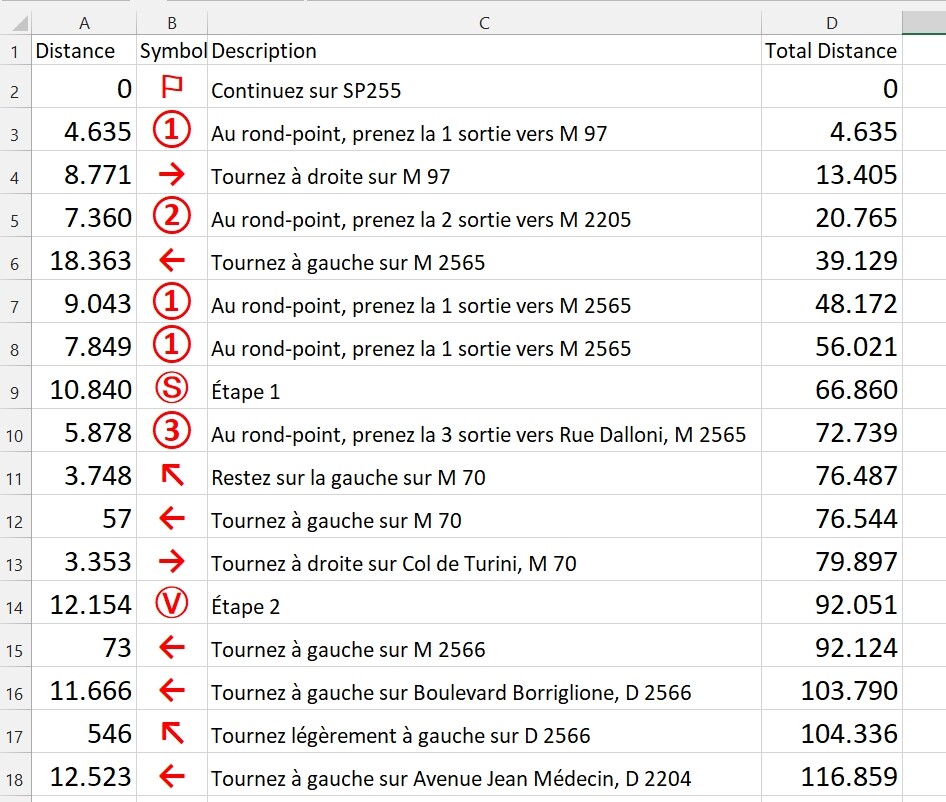

And with few adjustments you can create a fancy roadbock:
As I said - quite easy!
Thank you for your very helpful reply. I think that I can now get the Road Book in Excel – excellent

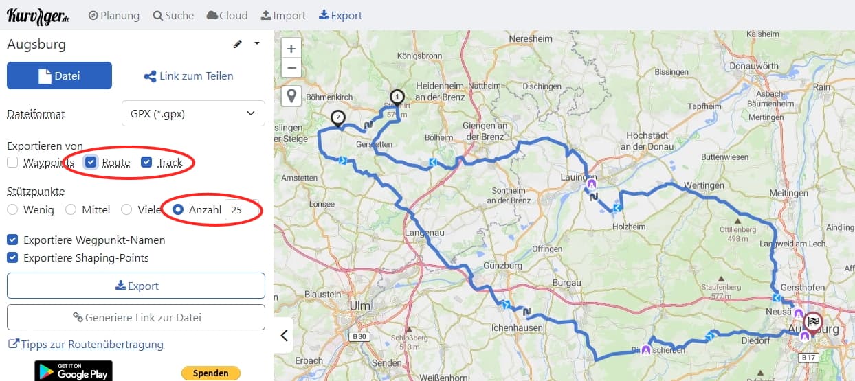

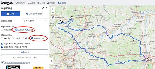

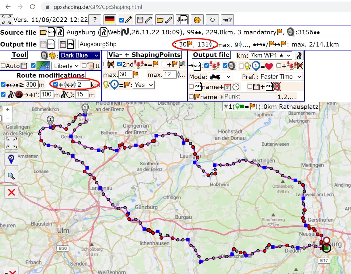

Not necessarily manually, you can insert additional waypoints during export:
This way you force a routing algorithm on your route.

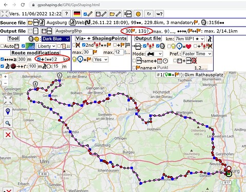

You can add even more waypoints with gpxshaping.de:
A bit complex - but with very good help information.
