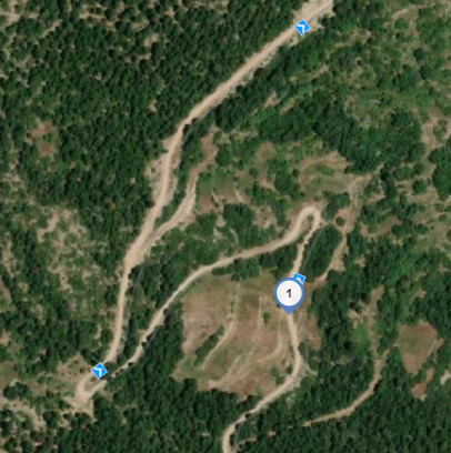

No surface information is maintained, therefore no chance for Kurviger to filter this road.
You can switch to satellite view, then you see the surface in such remote areas.
When you plan in the Webplanner “w” hides the route, so you have a better look at the map.

Yes, I did check satellite view but it was impossible to see any detail of the road because of the low resolution. Maybe there’s a (future) possibility to mark such roads (as “suspect”) if it’s “unclassified” ?
How would this help? A “unclassified” road can have different surfaces, dependant on available money / country. The better way is to look at the road then tag the surface in OSM. Therefore a unclassified road should always have a surface tag. Probably the road was taken also from a satellite picture and the mapper had the same issue.
