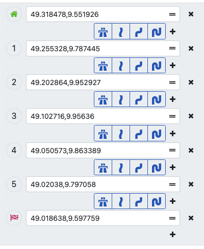

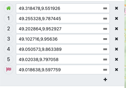

It could be possible to offer a compact version of the waypoint list and users can switch between a compact and a detailled version like this:
Would be good if you could provide a bit of feedback if this would indeed solve the issue you are facing.

I am planning my routes exclusively by hand, so there are very often 50 - 100 shaping- and waypoints. The buttons between every point are making such a long list really confusing and long.

  • brings more waypoint into the panel
  • does not reduce the width of left panel (as asked by some users)
  • removes option to change segment profile / insert waypoint via panel

This feature was added to the Kurviger Website. Please let me know if this works as expected.

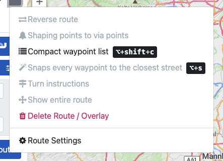

In this context I added two new hot keys:
  • alt + c: collapse / extend waypoint list
  • alt + shift + c: compact / detailed waypoint list
Let me know how this works for you and if it fixes the issues you are facing.
