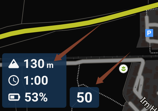

I got this as a PM and could reproduce it.
.. and height is also displayed as meters.
