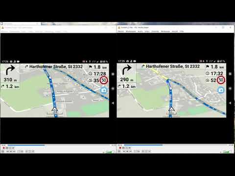

Animated location isn’t very important for me - I don’t look at the navigation system all the time. Anyway, to know the difference I drove the same short route once without and once with animated location - here the two videos side by side:
I like the right version more - thanks for the idea and the realization, Emux!
Thank you very much for the videos! ![]()

Oh sorry - yes it was off, probably switched off accidentally when switching back and forth of animated location.
No problem. The 2 settings work differently, but can be combined.
Kalman filter can further help with GPS estimation (extrapolation).
GPS location updates are at their best every second.
You can use the “Kalman filter” to estimate intermediate locations.
