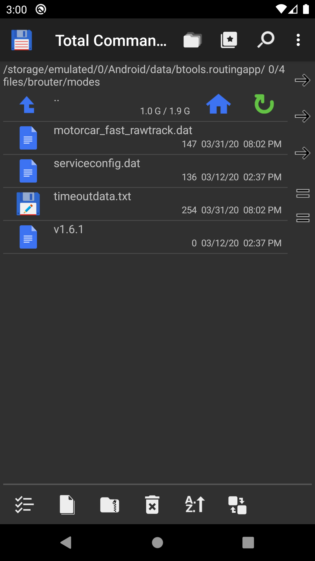

Or change the mapping in BRouter’s serviceconfig.dat file.
See also its readme in “Routing via the service interface” section.

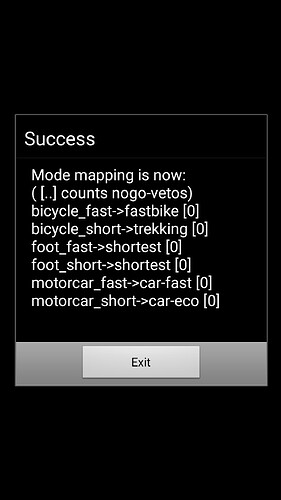

Hmmm, after proceeding like I described in my post above the content of my “serviceconfig.dat” looks like this, even after restarting the phone (just tested):
bicycle_fast Kurviger-smallroads
bicycle_short Kurviger-smallroads
foot_fast Kurviger-smallroads
foot_short Kurviger-smallroads
motorcar_fast Kurviger-smallroads
motorcar_short Kurviger-smallroads
Should be enough.
For this example I configured all BRouter profiles to use “Kurviger-smallroads” using BRouters own dialog interface:

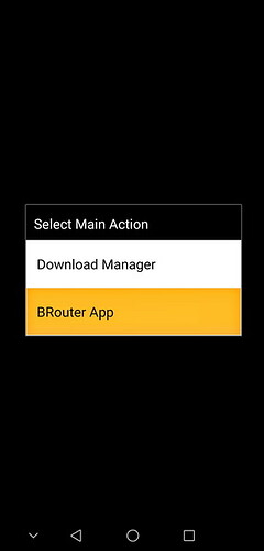

By using this BRouter dialog (several times):
So that it looks somehow like this in the end (I called the BRouter dialog three times to get there):
Advantage: possibility to use different BRouter setting for each of Kurvigers routing options.

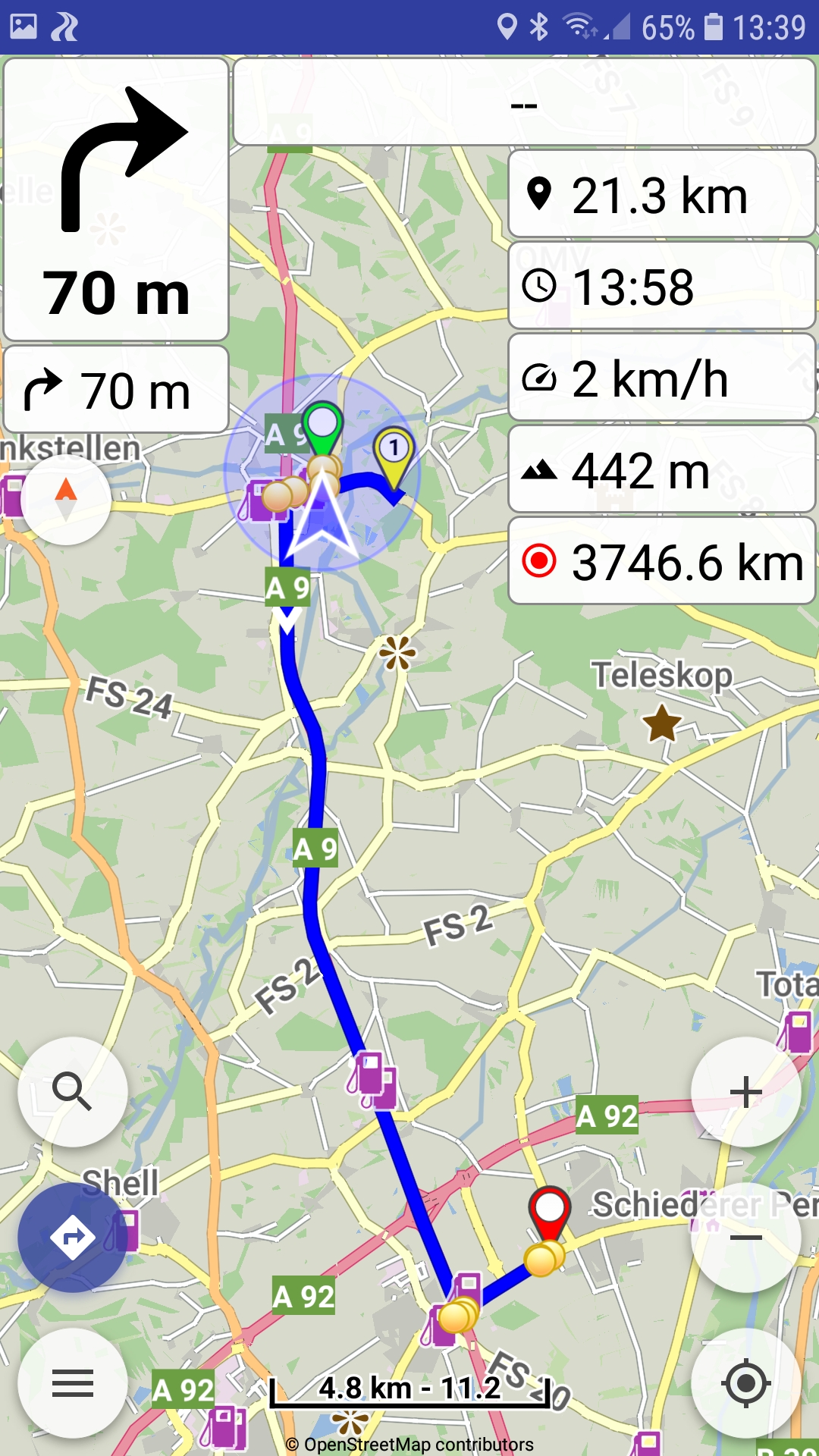

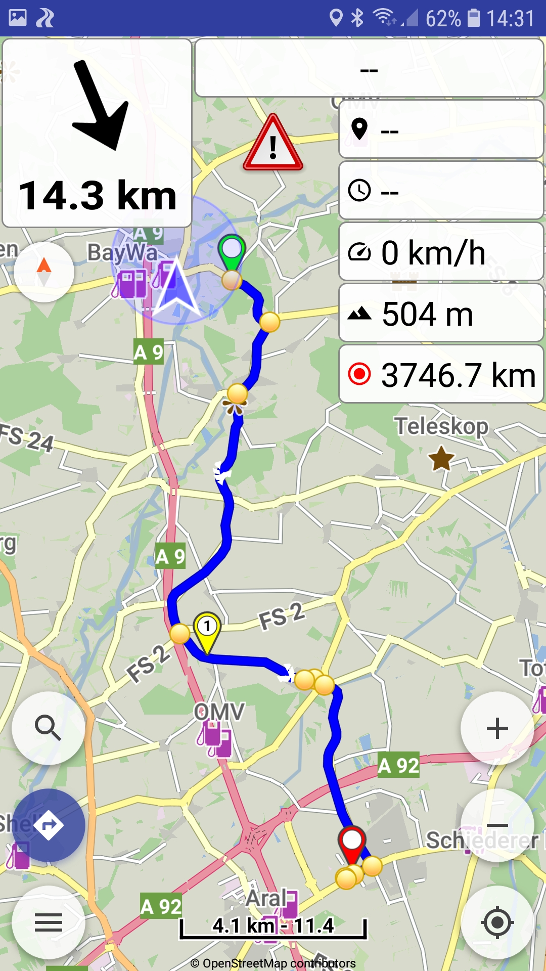

Here you see the first issue
The distance shown is towards the end, and not towards the next waypoint as I would have expected.
  1. Recalculate route to the start point.
    Now my original waypoint1 is lost and only original start point is left as wp1
    Edit:
    schouldn’t the distance field show the distance to the next waypoint (in the image above)?

I’m not quite sure that I understand the steps to reproduce the report. :slightly_smiling_face:
You imported a route in what form and with what active routing service(s)?
If not imported it as offline kurviger file, then a route calculation happens.
Here seems a BRouter calculation happens using imported coordinates.
Note that BRouter does not return via points in route instructions.
i.e. BRouter routes know nothing for via points, only start + end.
Also if waypoints exist inside avoided roadblocks, then they’re removed.
Indeed that seems to be the reason.
Note that each router behaves differently and then apps need to process the results.
GraphHopper and Kurviger return 2 instructions per via point. BRouter returns none.
So a post processing must happen, I will see if that’s possible also in BRouter’s case.
