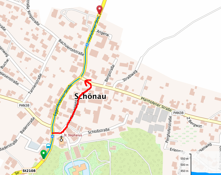

I have also observed this behavior to occur for the case when you leave a route (with auto rerouting disabled) and - later - rejoin the same route again. Consider this example:
https://kurv.gr/kt56q

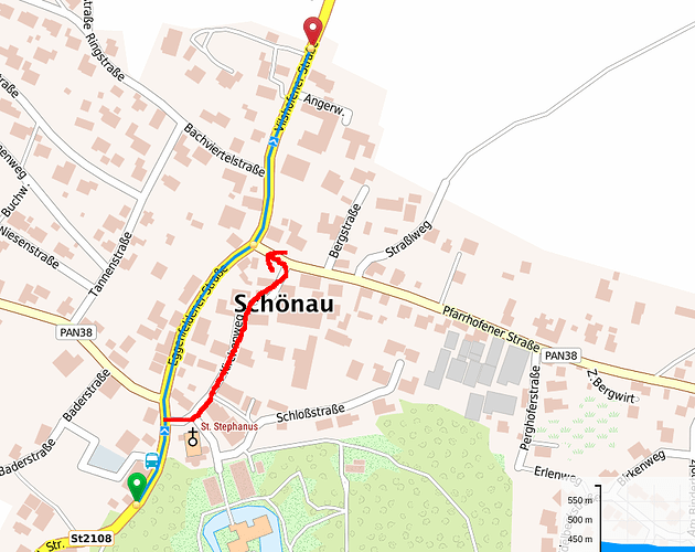

It contains start, end and a turn instruction in the middle, which asks you to turn left. If you follow this route from start to end all is good. If, however, you decide to leave the route and rejoin from, e.g. “Pfarrhofener Strasse” as shown in this screen shot:
you might still get the announcement to turn left even though this is wrong from the drivers perspective. This happens to me frequently. I have learned to live with this though as you can easily see the correct direction on the display anyways.

New turn instructions can be generated only after a rerouting.
If you resume a route even some meters before a turn instruction, then it’s still considered as valid.

I know. That’s fine. This is why I mentioned that I usually have re-routing turned off.
Yes, I understand that. The only thing you could do here is to ignore turn instructions in the vicinity of where the driver rejoins the route. But - as I said - not an issue for me as I can look at the display.
