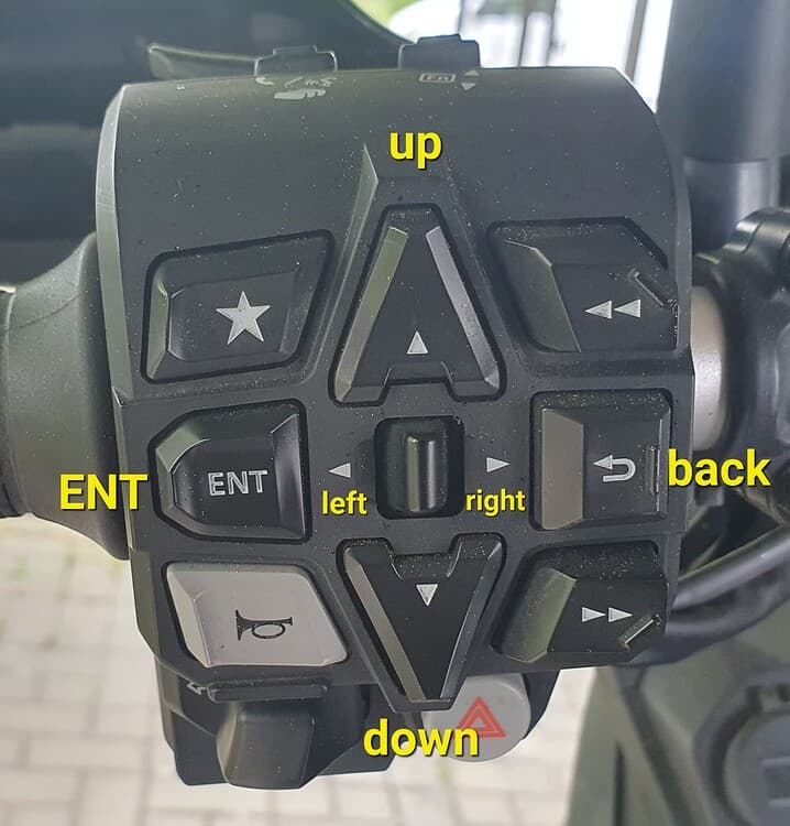

Left Handlebar Swiches Codes on Honda Africa Twin 2020-
With a friendly support of one Kurvinado, using Carlinkit Tbox UHD (“Android-Box”) and ButtonMapper App I have managed to determine key codes for the left handlebar switches on 2020 Honda Africa Twin. Those should be valid for all 2020-2023 and 2023- Africa Twin models. I am currently trying to figure out how to remap the keys to get more usability out of Kurviger App, although it would be a real added value if Kurviger Team could improve the support for handlebar remote controllers, not just for Honda, but also other 3rd Party products like BarButtons, Silverfox, ARM Remote Pro, DMD Remote, Wunderlinq etc…
I will use this topic to write about specific points, where the improvement for Honda would be appreciated, but many of them would probably be applicable for other remote controllers as well.
Key codes (LP = Long Press):
ENT - DPAD_CENTER (23)
:arrow_left: - DPAD_LEFT (21)
:arrow_right: - DPAD_RIGHT (22)
:arrow_up: - DPAD_LEFT (21)
:arrow_up: (LP) - DPAD_UP (19)
:arrow_down: - DPAD_RIGHT (22)
:arrow_down: (LP) - DPAD_DOWN (20)
:leftwards_arrow_with_hook: - BACK (4)
:leftwards_arrow_with_hook: (LP) - HOME (3)
:next_track_button: - MEDIA_NEXT (87)
:previous_track_button: - MEDIA_PREVIOUS (88)
